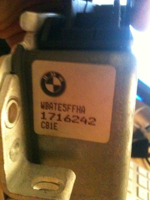

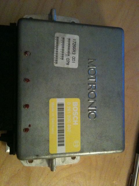

    I just took out a 380 ECU out of my E30, expecting to find a 153, that I changed with a 173. The Vin sticker on the ECU reads:
    WBATE5FFHA1716242
    It seem that this car does not exist??? When I search the last 7 digits in realoem I get an 1986 535i m30 e28 HOWEVER when I decode the vin here http://www.rubmw.ru/vincode/eng/ I find out that what Realoem and this decoder is decoding is vin number:
    WBADC740XH1716242
    Notice that the 7 last numbers are the same?
    Carfax, and other similar decoders are also unable to decode WBATE5FFHA1716242
    What in the hell is going on?

        Got a response from BMW Germany on this:
        Thanks for your Mail.
        WBATE5FFHA1716242 is not the VIN of your Car.
        The Sticker on the Side show many more information.
        Here the explanation:
        WBATE5FFHA << That is a internal General VIN
        1716242 << BMW Partnumber of the control unit
        C81E << internal code for programming
        Please check the vehicle registration documents.
        There you will find the correct VIN and I am sure you will find your car.
        If you have any more questions around electrical systems, do not hesitate to contact me.
        Greetings from Munich.
        Kind regards
        Eyk Radmann

                      380 is for an m20b25. The vin number on the ecu as explained by BMW germany is a general vin plus the part number.
                      This was likely a replacement ecu ordered through a parts desk at a dealership. The extra ecus that bmw has probably all have the "general internal vin".
