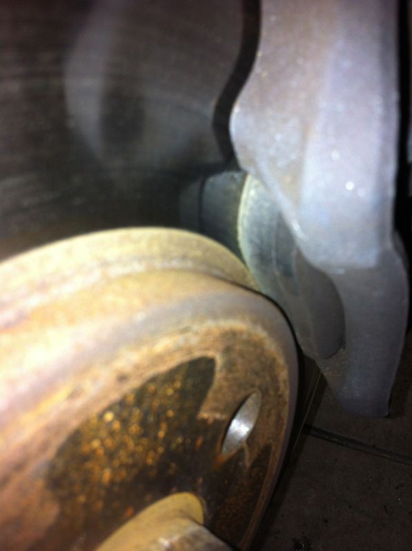

              Originally posted by kevmac858
              so my roommates and i went for a drive today and we have concluded that it most likely has to do with the brakes. when i took it in for an alignment earlier they said the brakes would need to be replaced soon but they indicated it would be in the next year or so but i'm guessing this would be the main reason. might spray some brake cleaner on it and see if it stops but i doubt it will :/
              I wouldn't trust the alignment shop telling you you need brakes. This picture is of your brakes when I went through the car.
              As you can see the pads are very close to the thickness they come new. Oceanside Motorsports also noted the brakes were good new in their ppi. It might be a noise attributed to the brakes or wheel bearing but the pads and rotors are in good shape. My last set of brakes and oem equivalent pads lasted 4 years of street driving. I hope this helps you narrow it down.
