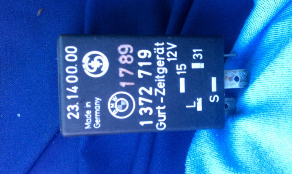

    I'm still trying to diagnose the ABS light on my E30. I pulled the Relay and took it apart, but didn't notice any link blown. (Attached). I pulled each wheel sensor, cleaned them and unplugged/tested them individually and still the light remained on.
    I'm thinking.... since both the front wheel connectors are deteriorated and crumbled, I might not have the proper wires/leads connected to each other. It might be sending the wrong signal to the system.
    Does anyone have the resistance numbers so I can ensure they are connected properly.
    Thanks in advance.
    P.S. is this the proper ABS Relay?
