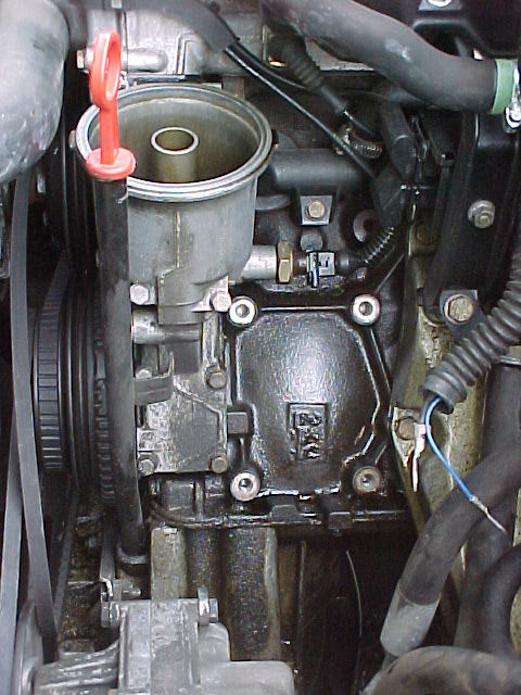

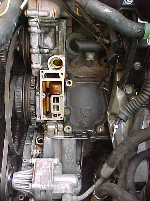

              What about the o-ring behind the oil filter housing mount, or the bottom of the dipstick tube? Mine was leaking in both places...
              FWIW.

                  I've had an oil leak for months that I can't find. I replaced the valve cover gasket just in case, but it looked good when I pulled it off and it still leaks. Mine is high on the engine, because the oil runs under the intake manifold and burns. Could that be the oil filter housing mount? How hard is that to change?

                    our oil filter housings are on top of the engine beside the intake manifold.
                      Yes, they sure are, at the top front - mine was leaking, mostly out the back towards the intake manifold, but some was going down the front. Not sure how much came from there, and how much came from the leaking o-ring on the dipstick tube that the PO tried to fix with RTV. Some was going down the front of the motor, though, which is why I mentioned it.
                      John in MD - 1991 318is
                      190k miles and still rolling!
                        Filter housing in place.

                          How hard was that to get to? It looks like you had to remove the alternator?
                            Not hard, but slightly time-consuming.
                            Yep, alternator, air cleaner, AFM, intake bellows all had to come off. Not too hard after that! :)
