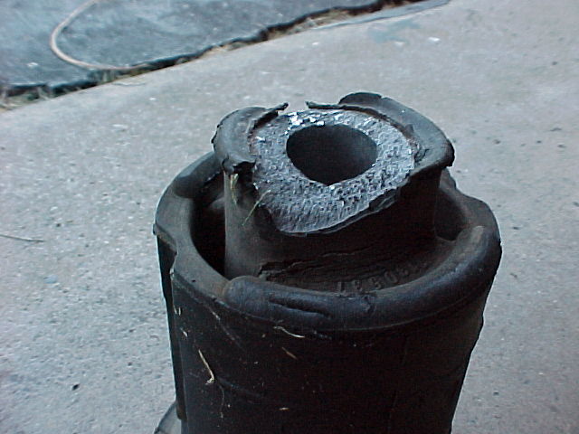

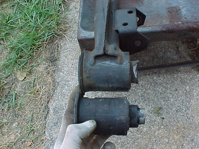

                      wahoo i got the sub fram bushing to seperate, it was really easy i can't believe i didn't htink of it before, i just used a punch and hammerd the metal insert of the bushing sideways and worked my way arround in a cicle and it eventualy just fell. and then i took it to my friends and we made a jig and pressed the bushings out. ps: if anyone ever does this, those bushigns shoot out really fucking fast, so watch out. it shot across the shop and put a dent in the wall:D

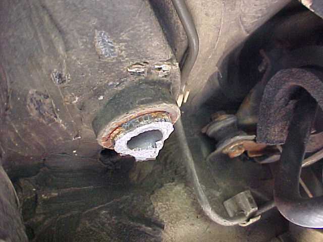

                            well it finally came out, it was f**ked. The driver side bolt is totally frozen in there, but penetrating fluid overnight took care of that. The bolt is still frozen, but at least the subframe dropeed from around it. The passenger side is a different story...
                            The bolt is totally out, removed through the back seat area, but the bushing is still frozen on there. The subframe is out, but the bushing stayed on the car. I can't believe it, nor have I ever seen that happen to any bushing before. Thank god I'll never have this problem again since it's getting poly bushing replacements and a whole different subframe. I ended up using a 4' pry bar to pry the subframe down from the bushing on the pass. side. It was ugly, and that was the only way it wanted to come out, but now it's done, time to start rebuilding....finally
