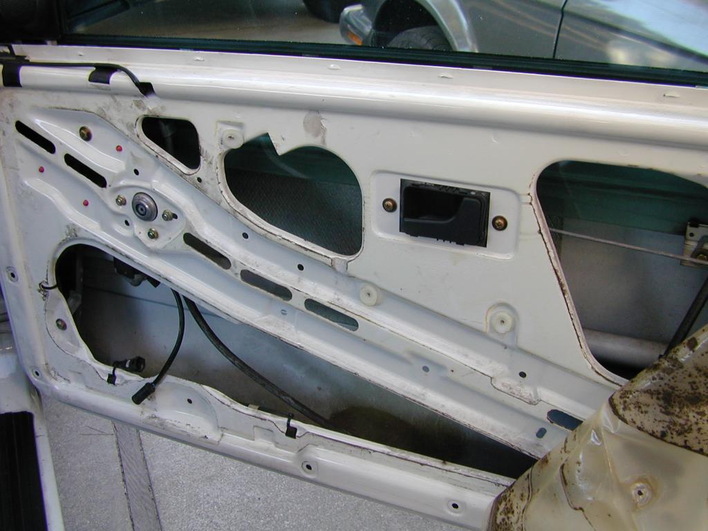

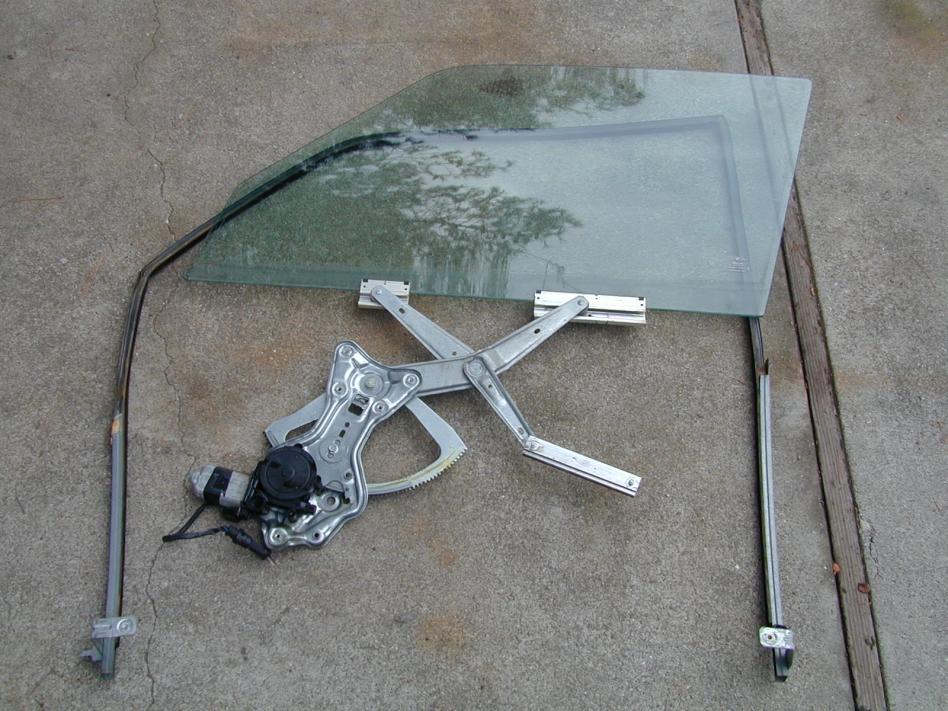

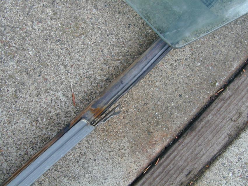

    Hope someone knows of the thread. I looked at the situation few years back when parting out a late model. From what I recall, the motor/linkage aspect is all pretty straight forward. The trickier problem was mounting the perimeter track/channel that the late model needs. I have a few pictures of early vs late door. Alpine is early of course.

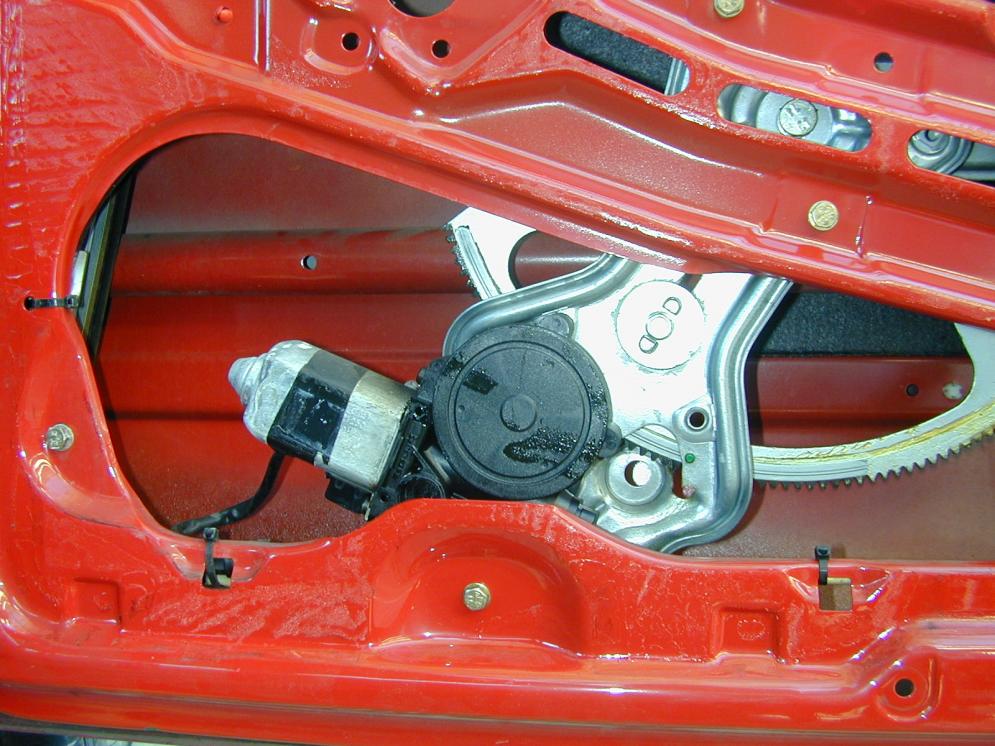

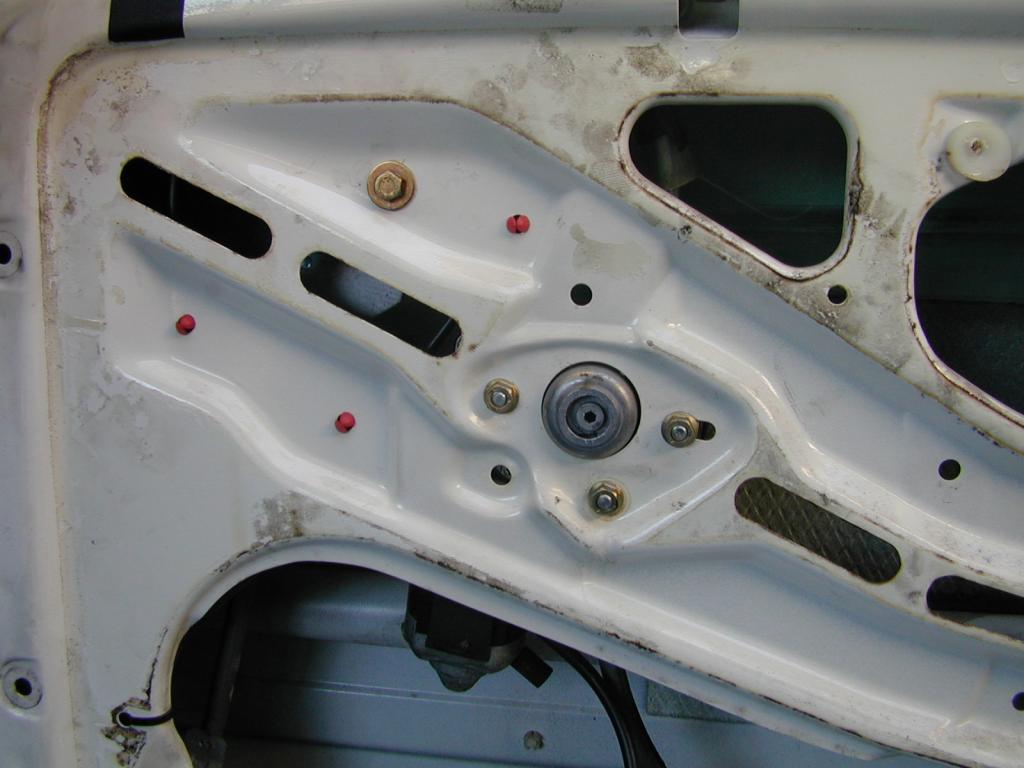

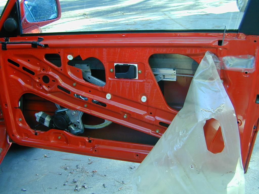

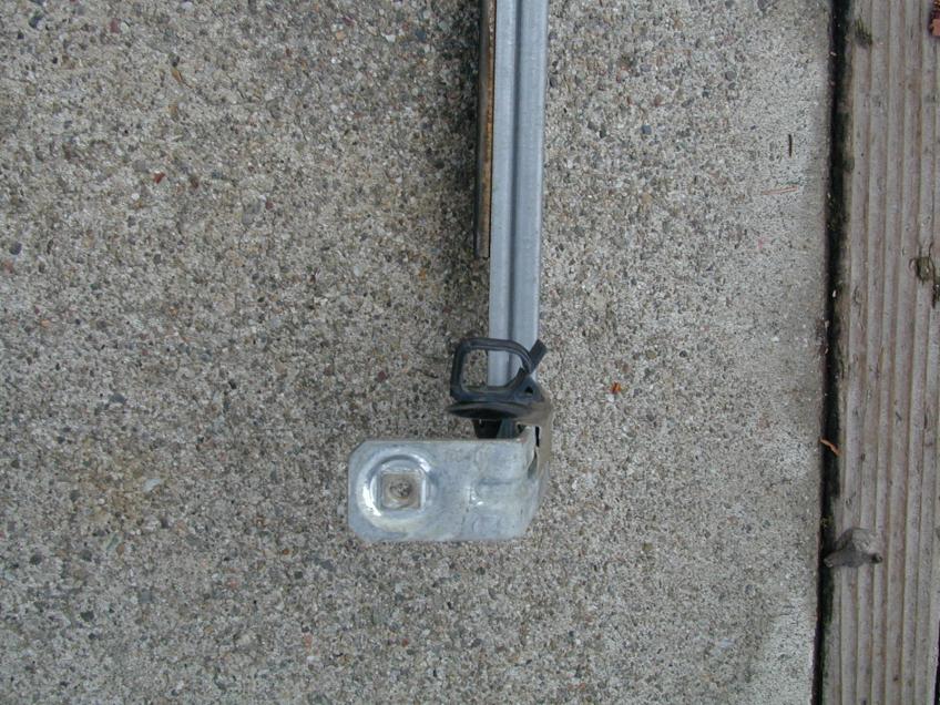

      Couple more

        Looking at the pics, the doors appear to be almost identical, especially the three bolts where the late model fastens.
        Can you elaborate on what you mean by mounting the perimeter track?
