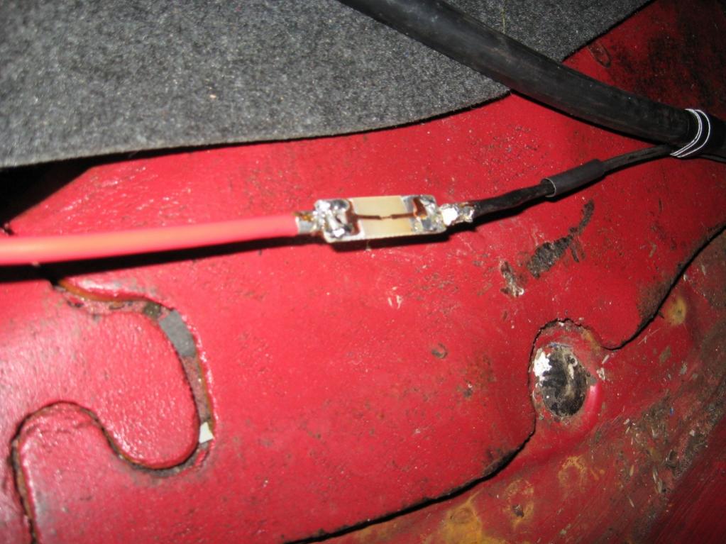

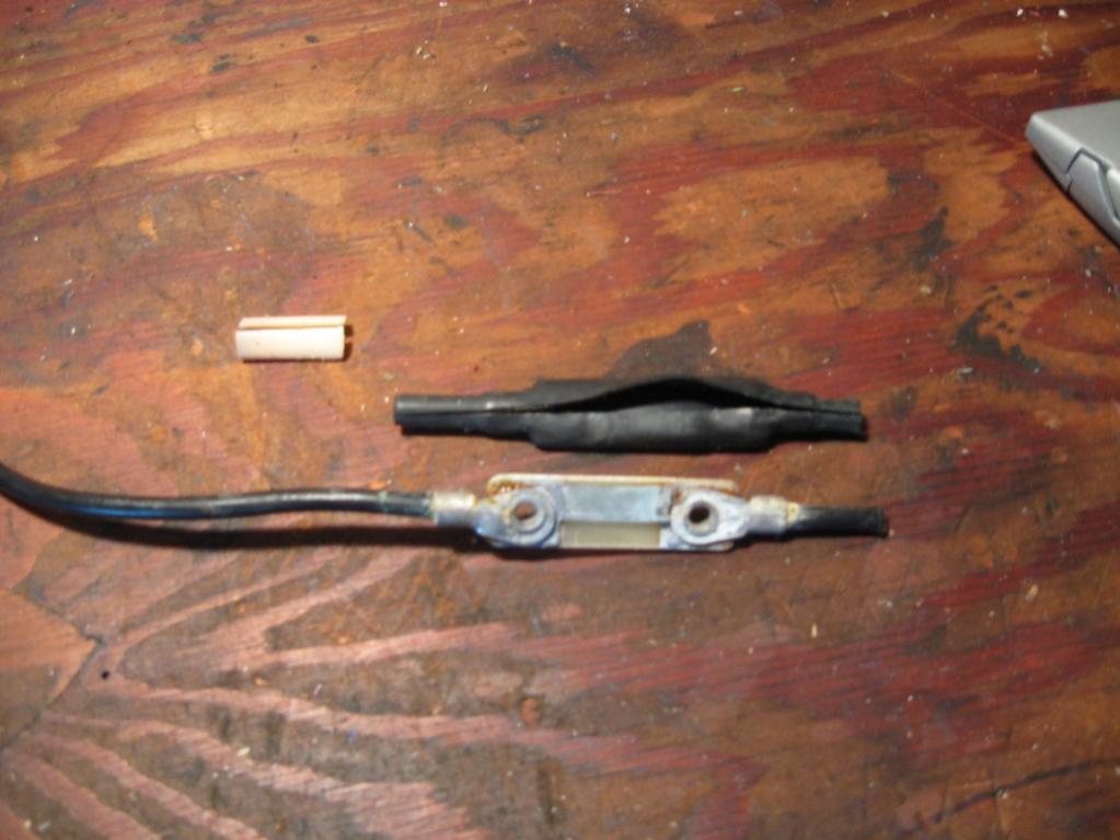

      Fusible link in the secondary battery cable.
      Mine did the same thing for three weeks before I found it.
      Looks good on the outside, corroded on the inside.
      I picked up a 50 amp replacement at Autozone and soldered the element to the original terminals.
      I hope that helps.
        I hope that helps.
        Yes, good point, and cheaper to try this first.
