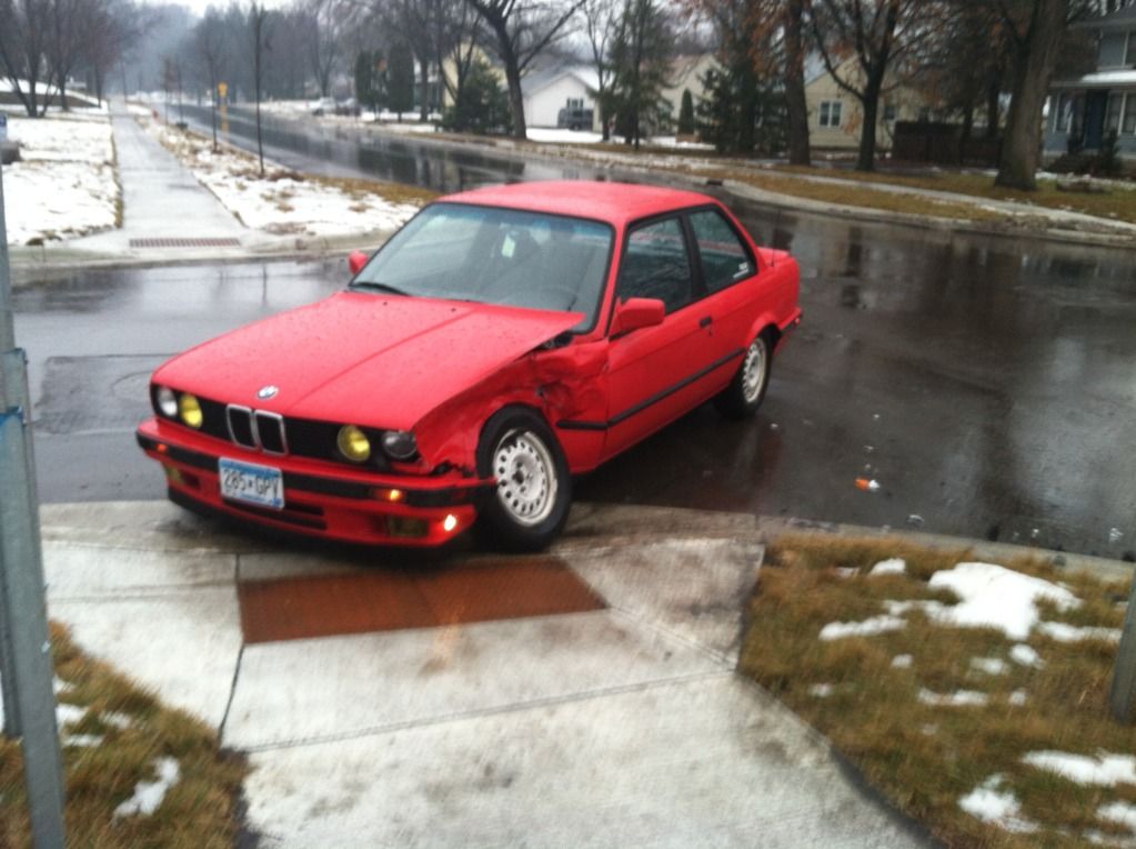

    So I bought a "new" E30 last week after my beloved 318is was totaled. I have a starting/ignition issue and a motor issue with the car that I will get to further down.
    Here's before the death...
    And after:
    And here's the seta, 1988 325, 5 speed, 218k. (picking it up, then in the shop with its fallen brethren)
    I'm keeping the 318 to nab parts from and will eventually scrap it when I've snatched all I can from it.

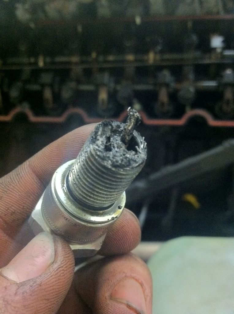

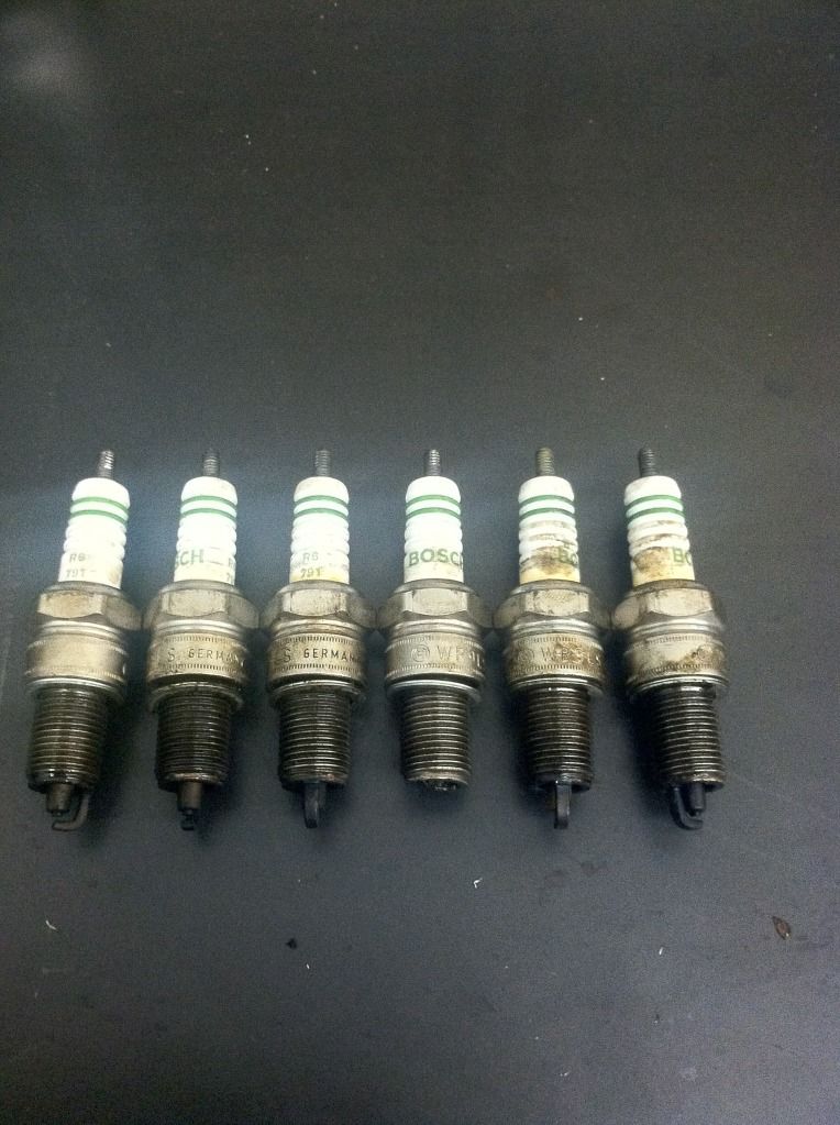

                  So I pulled the spark plugs tonight, shoulda done that a while ago because I found the motor issue! Kind of at least, it seems to be that a valve went nuts during the over-rev...
                  Leading to this;
                  Can anyone spot the bad egg?
                  I'm going to try to get the head off this weekend, to check for piston/cyl wall damage. Its in the #3 (from front of the car to the back) cylinder, all the other spark plugs look as they should so I'm hoping its just the one.

                  I turned the motor over by hand earlier this week as well, it felt very smooth and seemed to have good compression. Timing belt would be fine then I'm assuming?
