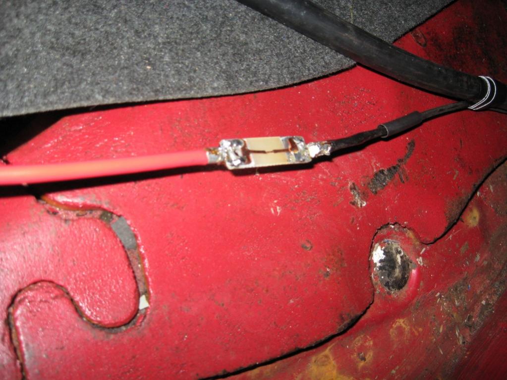

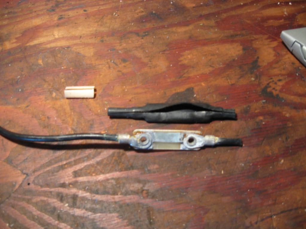

        Might want to check the fusible link in the secondary battery cable.
        Mine did the same thing for three weeks before I found it.
        Looks good on the outside, corroded on the inside.
        I picked up a 50 amp replacement at Autozone and soldered the element to the original terminals.
        I hope that helps.

          I'll check that out today. Is there a specific fusible link I need to pick up to replace it?
          • jlevie
            • Nov 2006
            • 13530
            The fusible link is rated at 80a, but I know that a 60a fuse will work.
