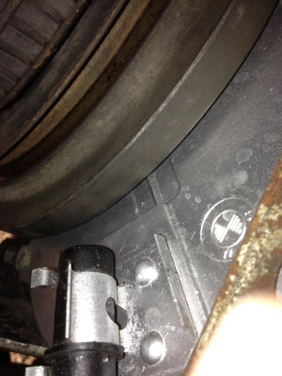

        If still not starting - the crank position sensors can ohm out OK but still be bad. But before replacing them double check that the metal slug that triggers the sensors on the flywheel hasn't gone missing.

            Its actually some type of metal pin that is attached to the edge of the flywheel. As the pin passes the crank position sensors, the sensors pick it up and tells the DME the crankshaft position (sensor #1) and the engine speed (sensor #2).

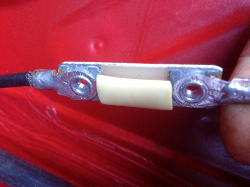

                • amcink
                  • 788
                  Ok no spark at the spark plug but found some trace of fuel however i still not hear either pump and as you can see the fuse link is fine so I think is the dme. I will look for the Bentley to see how I can test the dme

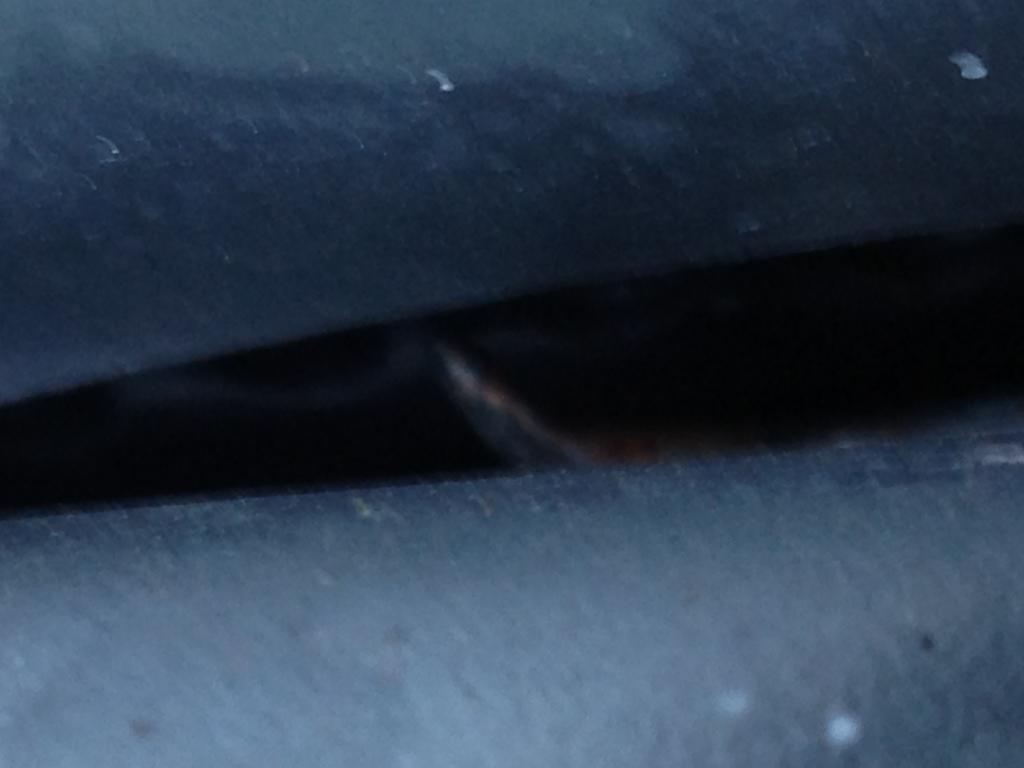

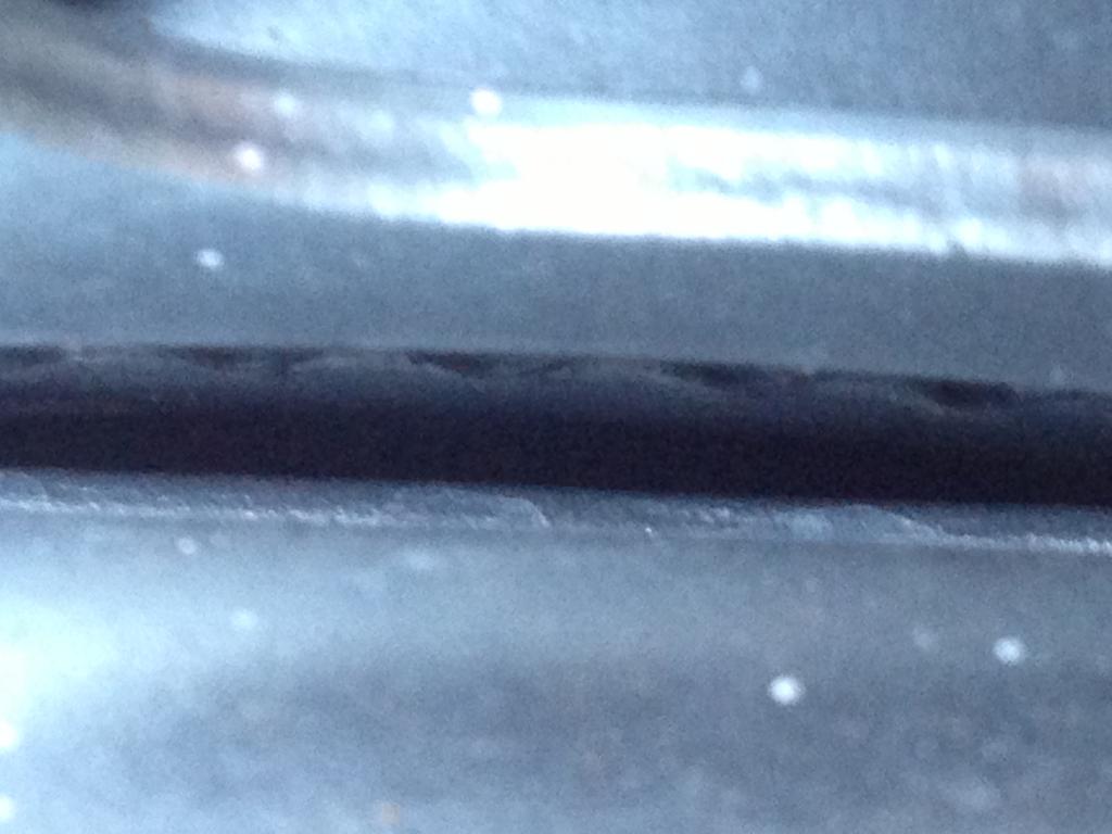

                          • jlevie
                            • Nov 2006
                            • 13530
                            Originally posted by amcink
                            As mention before the belt has only 300 miles. It's new
                            But have you checked to see that it is good?
                            Jim Levie, Huntsville, AL

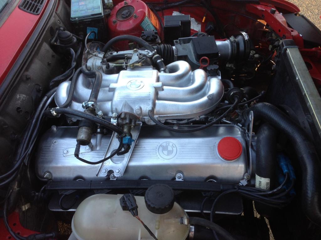

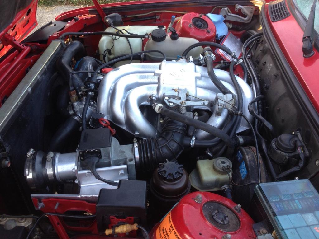

                            • amcink
                              • 788
                              My engine bay. The next two photos shows the area were you can see the TB and I'm poking the TB with small metal thing. Therefore NO broken TB
