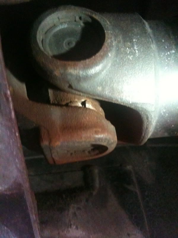

          • ///M42 sport
            • 3952
            check your ujoint? I had a crack in mine causing clunking under acceleration
            Renting my rear wheel bearing tool kit. SIR
            http://i25.photobucket.com/albums/c5...ps6debf0b0.jpg
