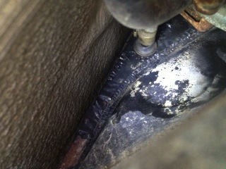

      I believe that this is the leaking line. There are three lines that run along the bottom of the car and this is the middle one. It turns to rubber and goes upward into the edge of the tank (Its about halfway up the tank which would explain why I can't put more than a half a tank in without dumping gas all over)
      Please, someone help me out.
          I had the exact same issue of not being able to fill up more than half a tank without spilling at it was that o-ring.
          The picture you've posted is of the fuel feed line. It's goes through that grommet and across the top of the tank but connecting to the pump with a short piece of fuel line. There is no reason why this should be effected by your fuel level as it is not entering the tank there.
          Again, I suggest you replace the fuel pump o-ring first as it is a known source of the exact issue you have.

                          There's probably a good chance that hard metal pipe that runs across the top of the tank (and is welded to the tank) is rusted. That's where mine rusted through because of salt water/brine setting on top of the tank from the winter roads. And seeing that you're in CT, you could have the same issue.

                              On Friday I took the plunge and started to drop everything. I dropped the entire exhaust including headers (I installed aftermarket), driveshaft, and all heat shields (I painted them all). Saturday I dropped the tank and installed the new one, installed driveshaft and entire exhaust. Car wouldn't start so I went back to work this morning and found a fuel line that I had switched. Now it runs but I have a terrible header leak! Going to bring it to a shop this week and have them do the headers and weld the new section of exhaust that I installed. Thank you everyone for your help and advice!
                              Edit: Also, the welded line on top of the tank rusted through and was definitely the source of my leak!
