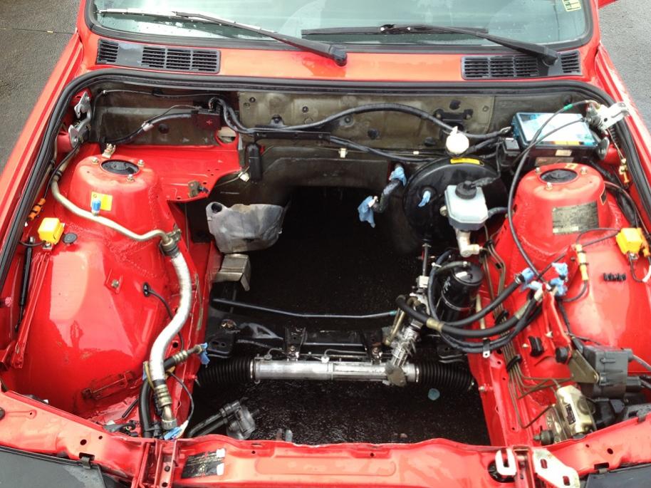

        Purple power, and pressure washer.. i only covered fuel lines, coolant hoses, power steering, AC, and the whole for wiring harness.... and sprayed the shit out of everything.. let it soak for 15 mines and then spotless...

        • z6ne
          • Dec 2012
          • 758
          ^ nice
          • SlamedIAm
            • May 2011
            • 318
            That steering rack is night and day, black to silver.
