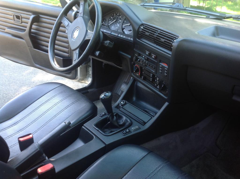

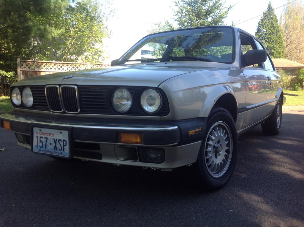

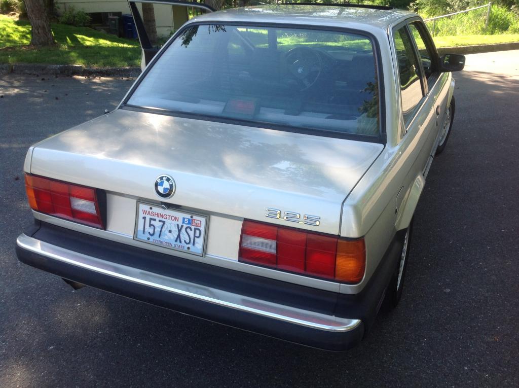

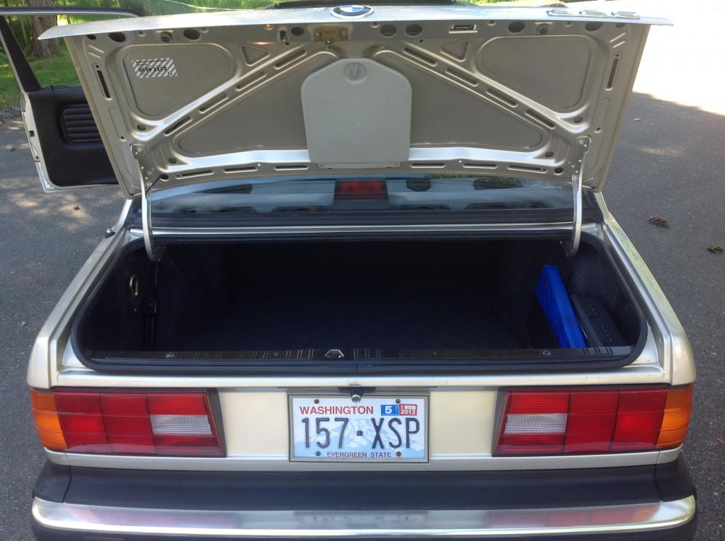

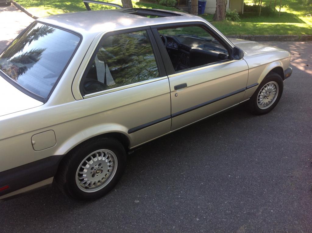

          RUT ROE - jumped off into the deep end - pics to follow........
          Thanks for all the help, in the end - the right car fell out of the sky and hit me in the head
          I know what I said - but I found an 88' Euro Deliver super eta 5 speed 2 door that was just to hard to pass - I had planned to wait for a nice 318is - but i am just no good at waiting
          pics to follow -

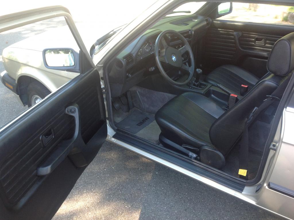

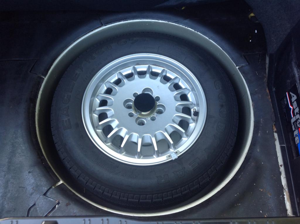

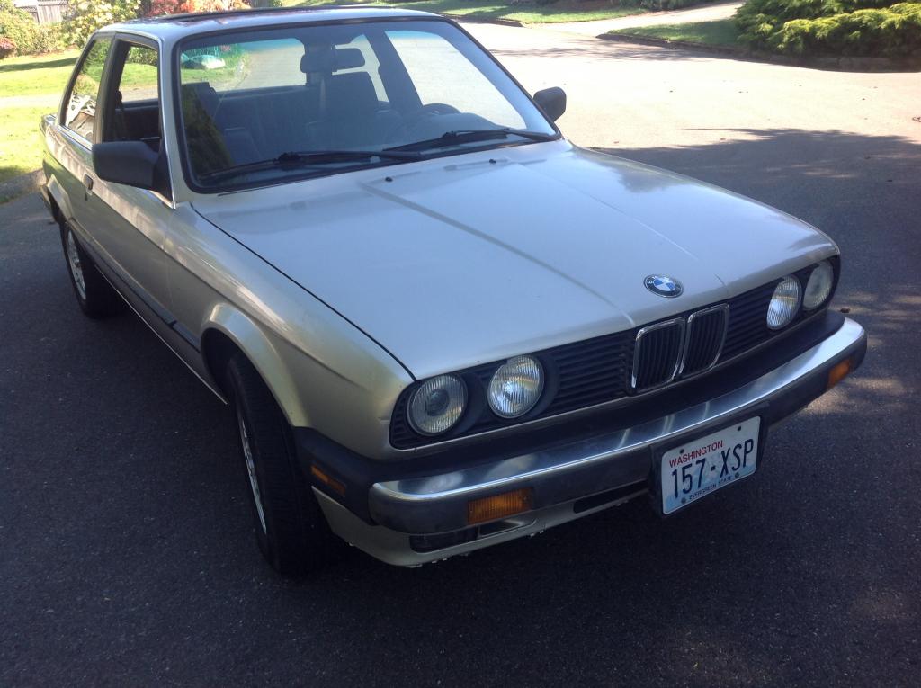

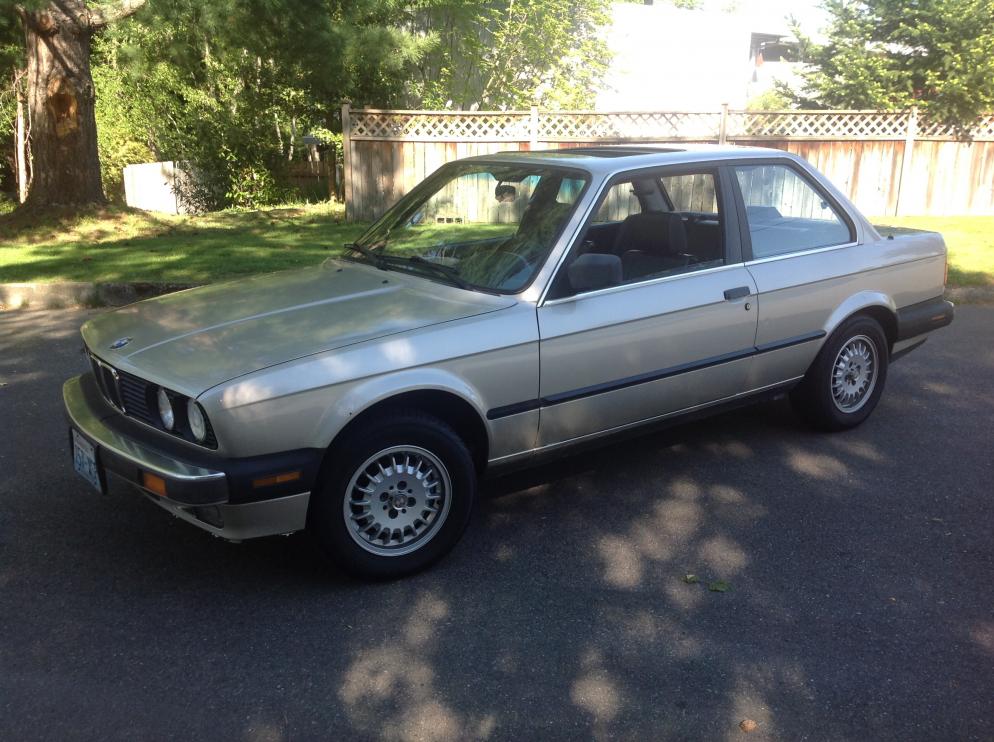

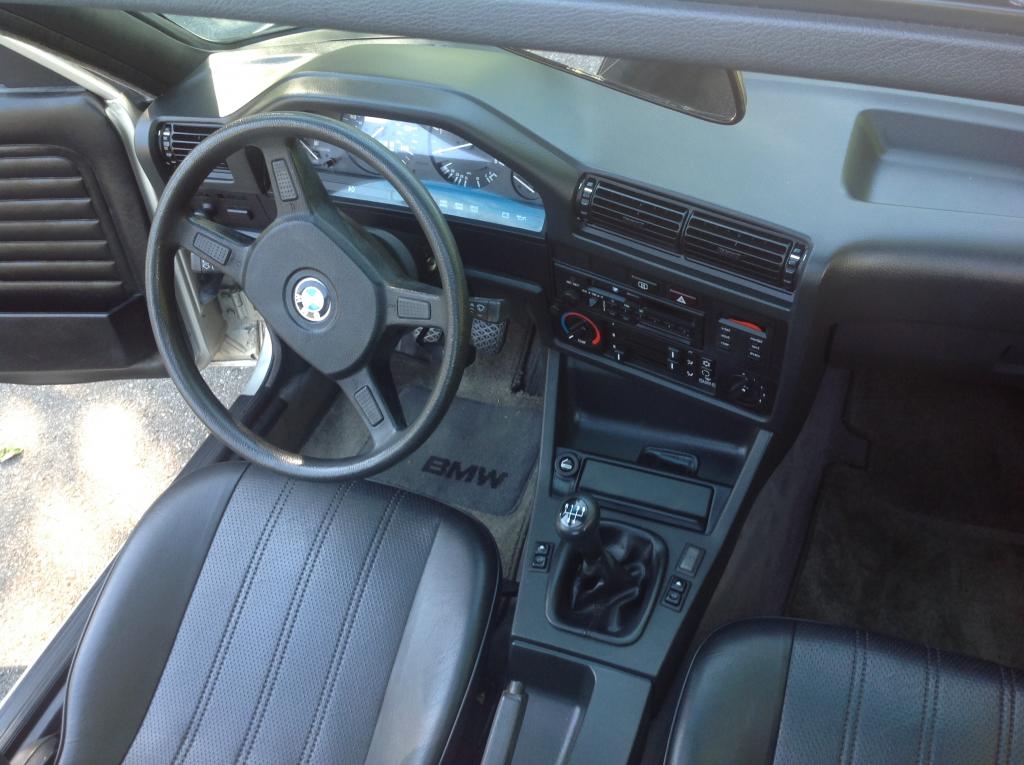

            Pics
            • ivangene
              • May 2013
              • 41
              more
              • ivangene
                • May 2013
                • 41
                and a few more - (not liking this file system...betting there is an easier way)
                • ivangene
                  • May 2013
                  • 41
                  geesh, this guy is excited
                  • roguetoaster
                    Biggus Tippus
                    • 7830
                    I think you have a good one there!
                    • ivangene
                      • May 2013
                      • 41
                      Thanks, no buyers remorse yet, but I stepped up a little for it
                      Something about not starting with the need to fix things right away appealed to me
                      I'll tech it and see how it does in a novice track shake down, see where to go from here, but plan to just keep it simple....after all, if I waned a full out track monster, I would not start with a nice clean interior ;)
                      • SmokeE30
                        • 1730
                        Looks great. I have a 88 seta as well, it's a great model, you get almost everything an I car does except the cam and valve springs, it will make a for a great car to Learn on then upgrade the cam and topend and regear it to have I car performance.

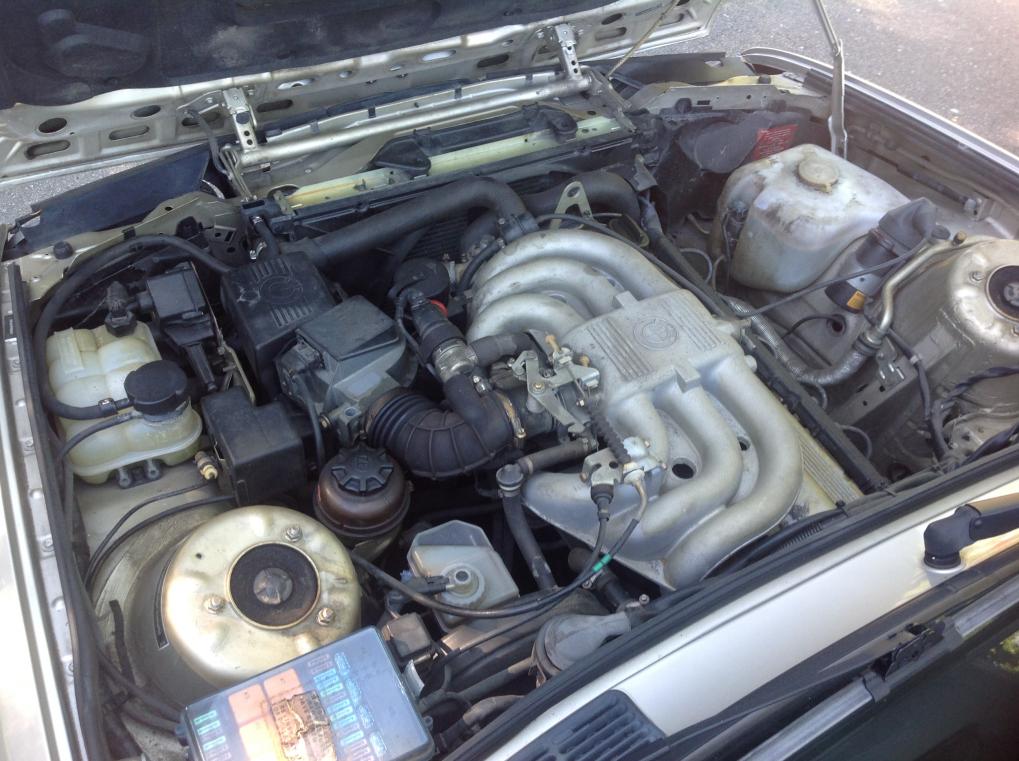

                          So planning a base line maintenance program, guess oil change is the first step....
                          Any oil suggestions - hahahah!
                          I'll pick up some things though and go through the car, seriously, what is my "must do/check list"

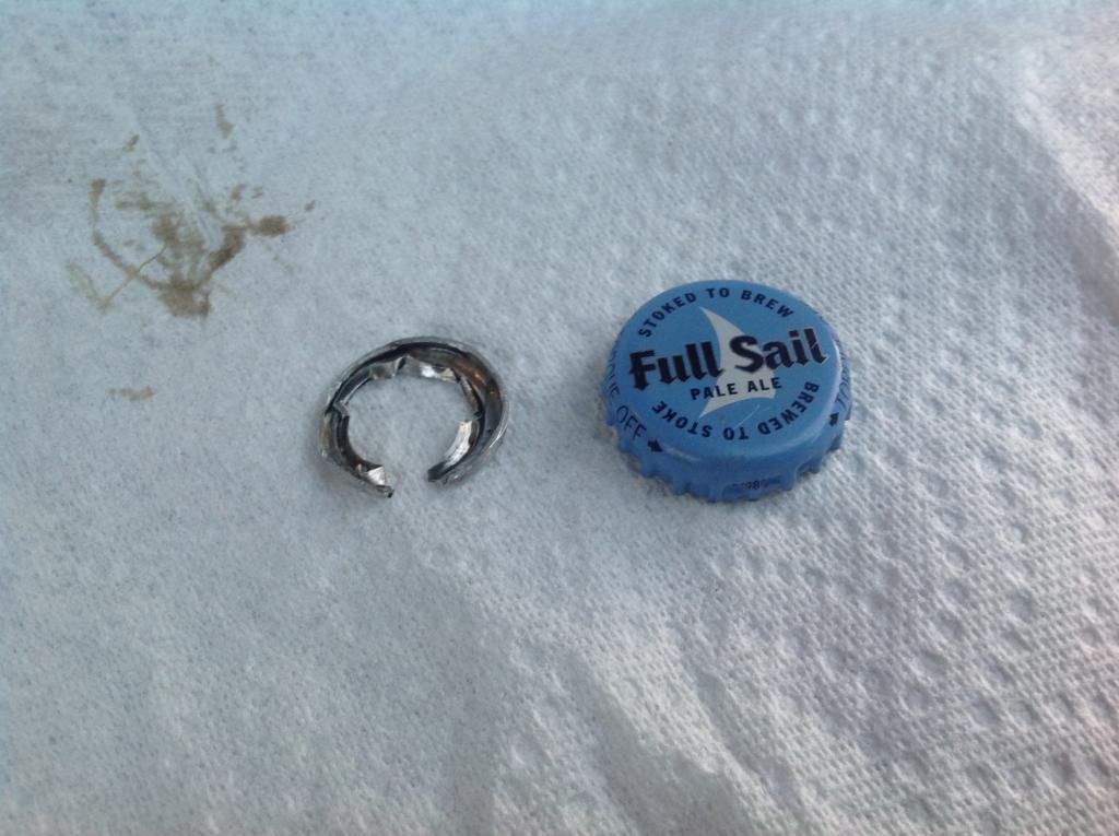

                            Hmmm...love it when you find the right parts, installed correctly....oil drain plug seal ring :roll:

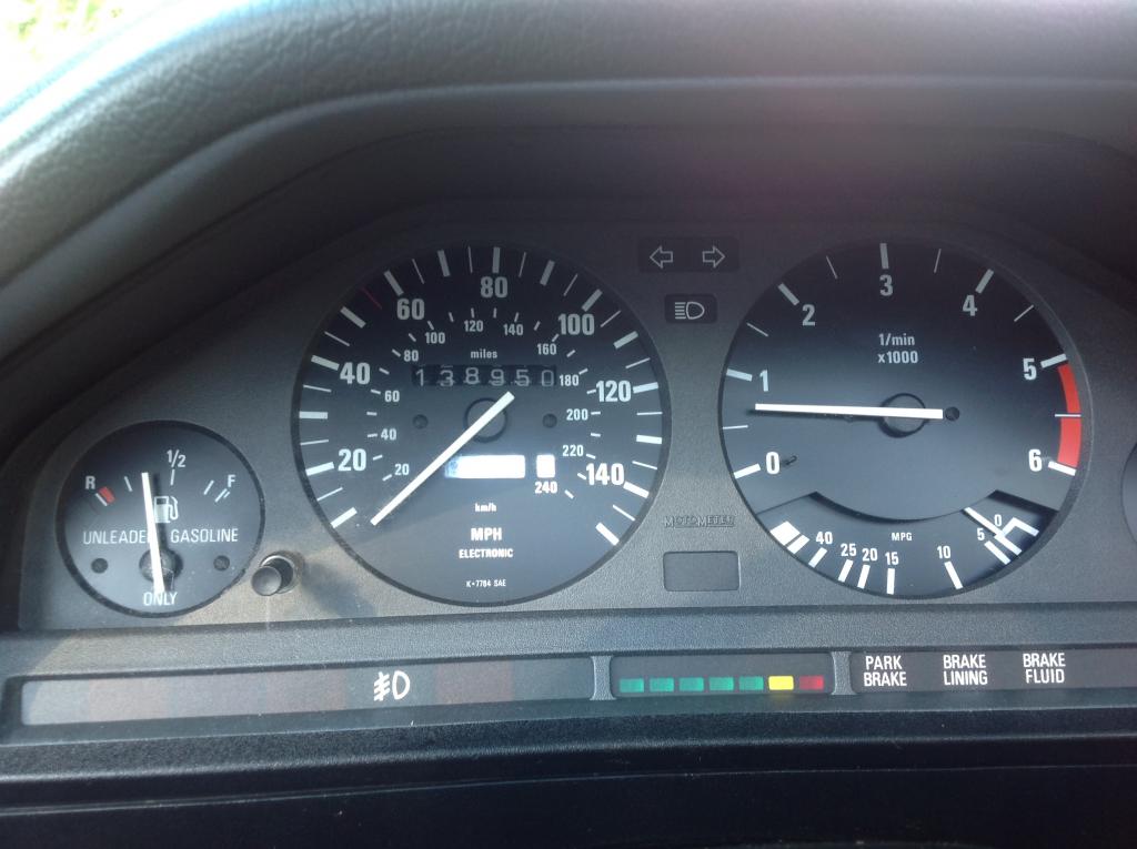

                              Nice looking car. The cooling system looks way past its prime. I would replace the radiator, t-stat, and all coolant hoses. Check the fan clutch. Replace intake boot, all spark plugs and O2 sensor. When was the timing belt/water pump last changed? I would do that too if it has not been changed recently. Perform a valve adjustment. Clean the CPS off all the built-up gunk (brake cleaner works well). After that, have a shop perform a smoke test to find any vacuum leaks. Trust me on this one...a proper smoke test will save you tons of headache down the road. I am sure there are other things you should do, but these should be the minimal PM for your car. Enjoy your E30.
                              • dnguyen1963
                                • Nov 2011
                                • 2651
                                Oh, one other annoying thing that you should take care immediately...take out the instrument cluster and check the SI board/batteries. If you see corrosion then you should have the board re-built. If everything looks good you should still check/replace the batteries (they are over 20 yrs old). Also, remember to tighten the ground nuts behind the gauges or your needles will go dancing or scare the shit out of you when the temp needle approaches the red zone.
