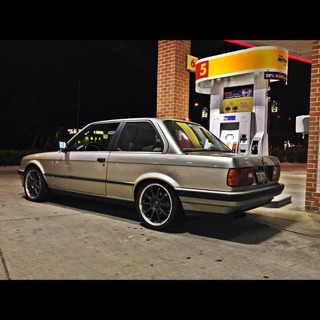

    Hey guys, my names Joseph. I've been lurking around here for some time and I finally decided to join. Glad to be here. I currently own two e30's. One is a 1989 325i
