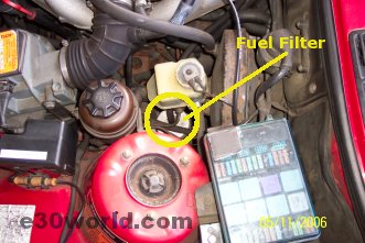

        have a look at what im pretty sure is an eta engine bay. if the filter is not where it is in the picture then its back by the rear wheel. I know there are three hoses that run there, supply, return and the breather to the charcoal canister.
          The car is about 3 miels away so I'm going to trust bentley and realoem and bet that the fuel filter is by the rear wheel.
          That being said I know there are hoses and it's probably a leak at some connection point (fuel rails to hose, to possibly a connector between 2 hoses).
