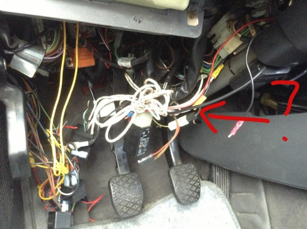

      Is it this one? Theres just so many wires down there not sure thats the one. Also that blck and yellow wire leads to more wires bunched up together which then leads to a relay instead of a connector. Also i have not wired up the reverse light wiring harness yet, does this make a difference?
        Yep, thats the one, unplug that, and go to the ignition switch harness, unplug the black wire there and plug this one in.
