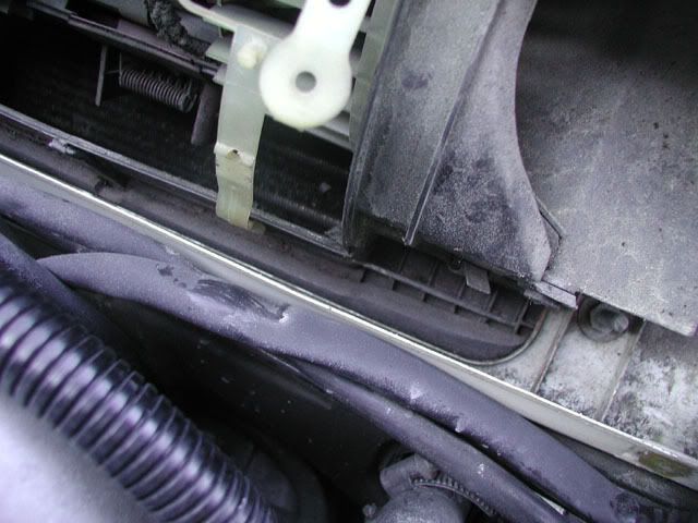

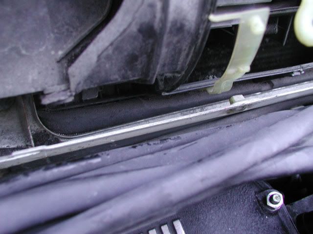

                      I constantly find water in my glove box when it rains. Sometimes I find the passenger side carpet damp and assume the water's point of entry to be from the same location. I've already checked the elephant trunk side vents, rocker panel oulets for blockage- everything is clear. I came across this thread and decided to give this fix a shot. Below are some pics of the foam just under the blower motor:
                      Thankfully, the rainy season is drawing to a close where I live. I hope the pics help others who have water leaks and have not looked here for a possible leak. Much thanks to royalflush313 for the find. Going out to seal this bad boy now!

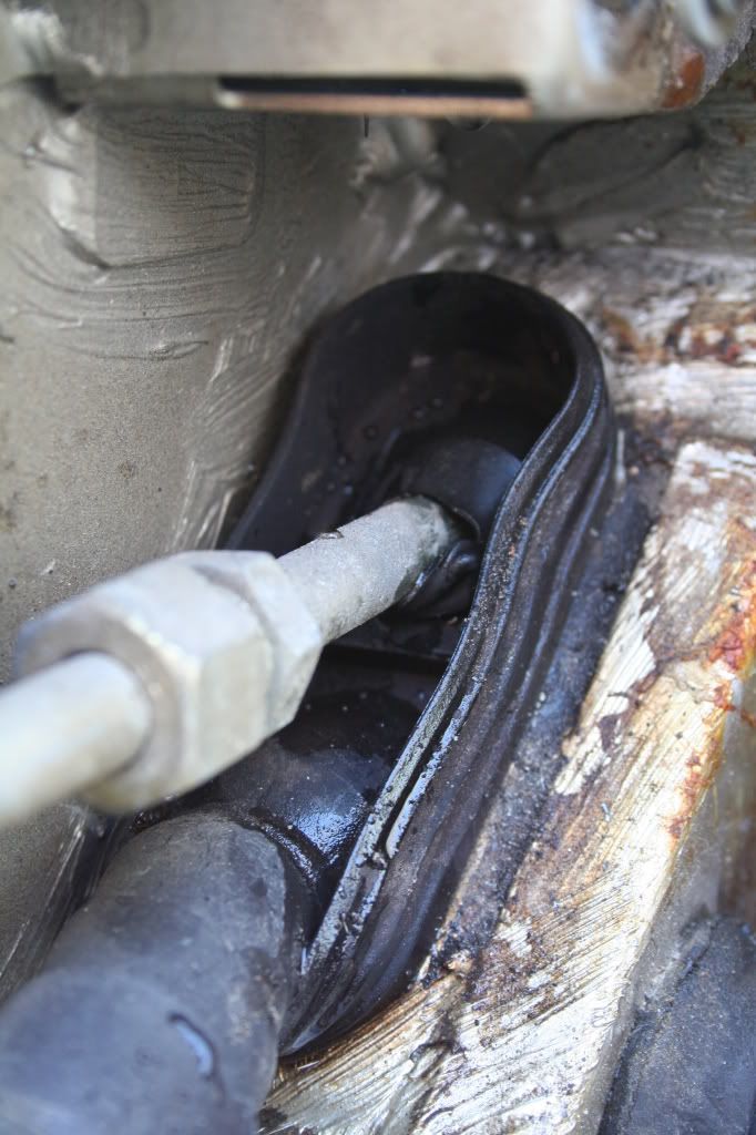

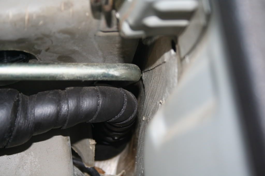

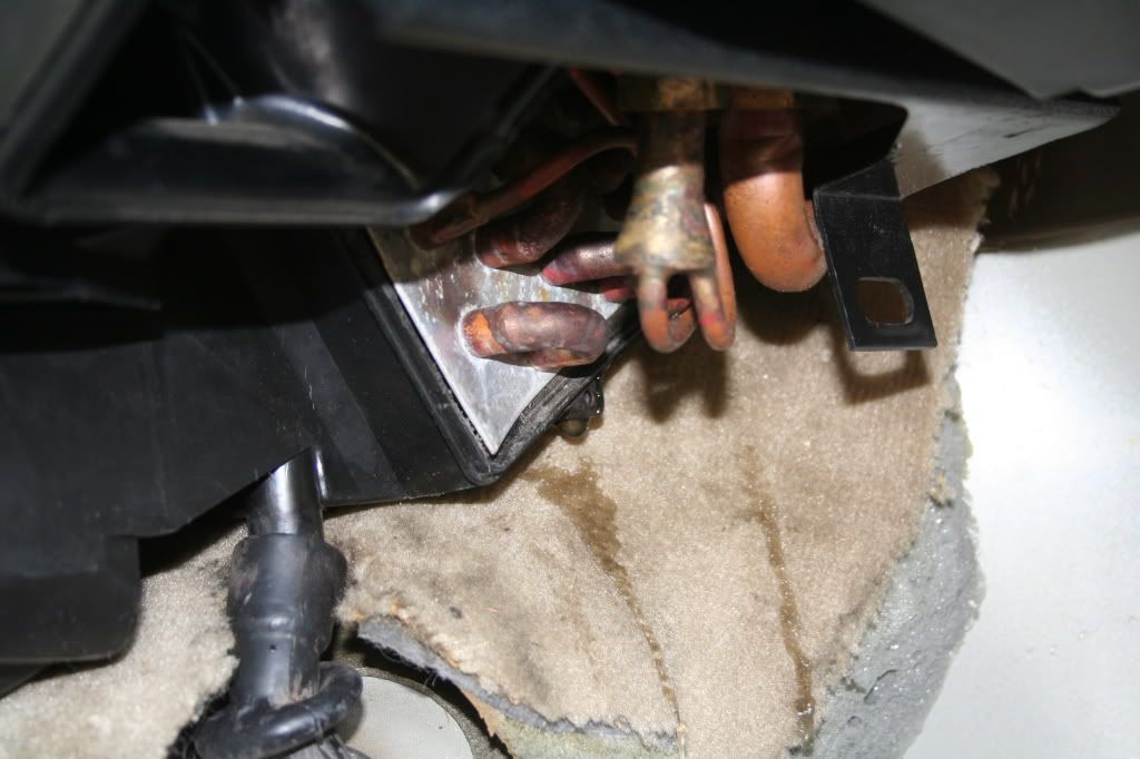

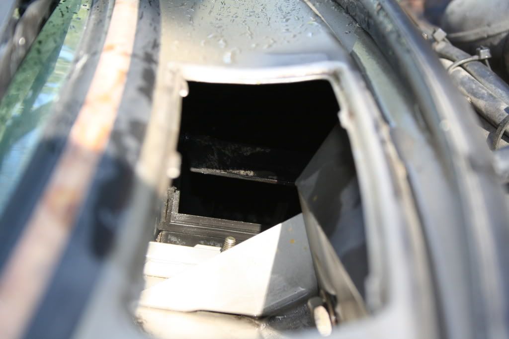

                            Back from the dead. I am tracking down leaks originating from this area. Anyone find a way to resolve it? I already have the whole dash out and am prepared to just yank this thing out. Also, the flaps that are on there are stuck open and if water splashed into there it runs on top of the carpet near the evaporator.
                            Heres some pictures to get a better idea:
                            Also check this area, I found a fairly obvious leak:
