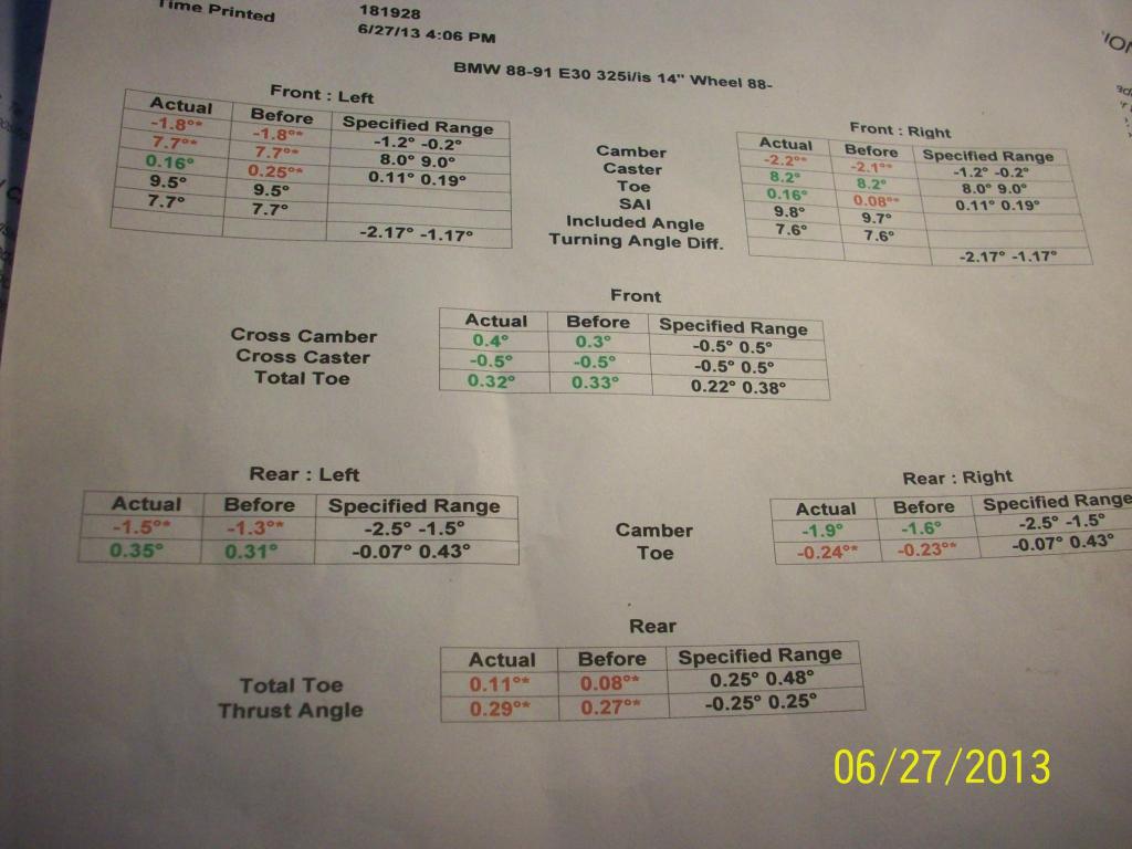

I just finished updating my 1991 BMW 325i with new Bilstein sports (front and back), new strut towers (Boge) and rear (Meyle HD) - New sway bar bushings front and rear (Lemforder), LH and RH Tierods..H&R Springs (used) that lowered the car 1"
I brought the car in to have it aligned:
These are the numbers (using degrees):
-1.8 FRONT LH Camber........ -2.2 FRONT RH Camber
7.7 FRONT LH COLOR=windowtext]Caster[/URL]........... 8.2 FRONT RH Caster
.16 Toe ............................ .16 Toe
-1.5 REAR LH Camber........... -1.9 RH Camber
.35 Toe.............................. -.24 Toe
I had my alignment done at a local shop in DSM (Sears) and I had a 175 pound person sit in the car while performing the alignment - which can explain the differences between LH and RH.
My question - Should I be concerned about my Front Camber (Do I need plates)?
Should I be concerned about the rear toe?
Here is a pic of my Alignment sheet:
