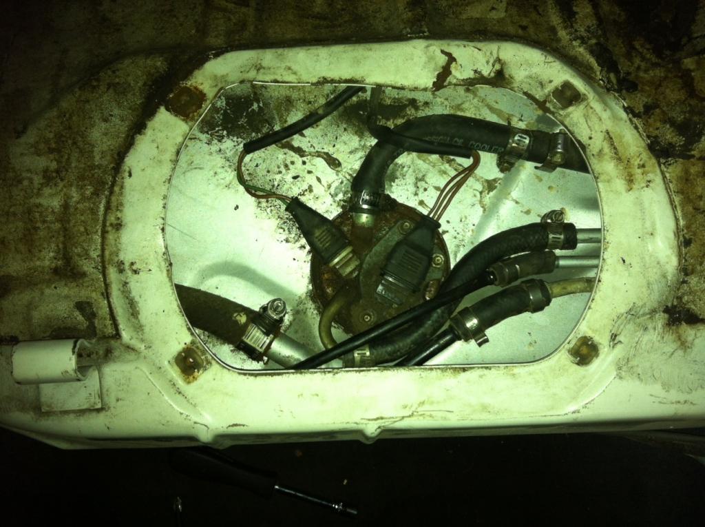

    Of that rebuilding I had to replace the tank. My question is my car does not appear to be equipt with an external fuel pump. The pump for the car is in the main sender unit that is sharing the space with what I presume is the fuel level sender.

    Here's a pic
    i think the 2nd fuel pump is outside on the drivers side by the rear driver side wheel.

      There is no fuel pump next to the tank. I believe there are some cut wires around that area, but no pump, just a fuel filter
        The pump shown is the standard low pressure transfer pump. The high pressure pump should be above the fuel filter under the car just ahead of the left rear wheel.
          The difficulty in fueling the car means that there is a problem with the tank's vent system. part of the system is in the rear of the right rear fender well and the remainder is the charcoal canister in the engine bay.
          There is no pump above the fuel filter.

              A prior owner could have replaced the in-tank transfer pump with an aftermarket high pressure pump (using the original pump bracket assembly) and eliminated the external high pressure pump.
