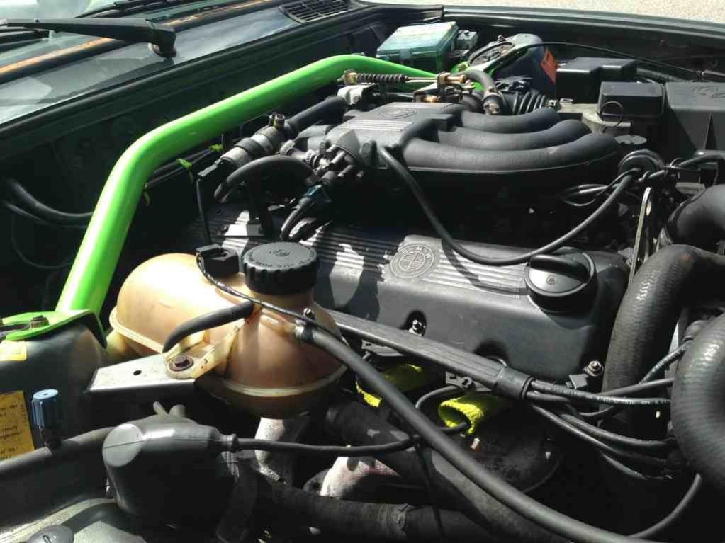

the other night sitting in a parking lot in idle I turned my defroster on and suddenly my car slowly began to die of power... at first my radio turned off then my tachs began bouncing up and down and finally my car bogged down and shut off... I got a jump from a friend and it ran fine until tonight it did the same exact thing leaving my buddies shop... the alternator is fairly new on the car so I don't think that's the problem. unless it's faulty... was leaning towards maybe my battery being bad? previous owner said it was a new battery but it's a cheap no name brand. I'm going to charge the battery out of my other e30 and swap it in then have autozone run a check on my alternator tomorrow ... was just curious if anyone has had this same exact issue and what the results were? thanks.
