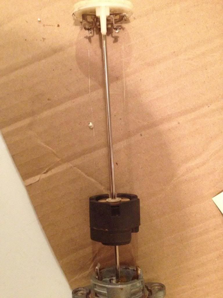

                      So my fuel gauge has always been a bit wonky. Reads full and empty fine, but "twitches" anywhere in between. Naturally, I decided to fix this when I pulled the sender to replace the pump.
                      My fix: Blowing compressed air into the weep hole of the aluminum housing. Good enough? Probably not. Let's shake the thing around a bit to make sure all the gunk is loose. Sounds like a rain-stick. Few more shakes, a few good whacks. One more for good luck. Yep, that'll do.
                      Here's a word of advice: Don't do that. Because this is what your fuel sender looks like on the inside:
                      See those tiny wires? They're about the thickness of a pube. They're fragile. They brake. Don't shake the damn level sender.
                      I soldered the wires back on their bases and whaddayaknow, the sender works again. PITA.
