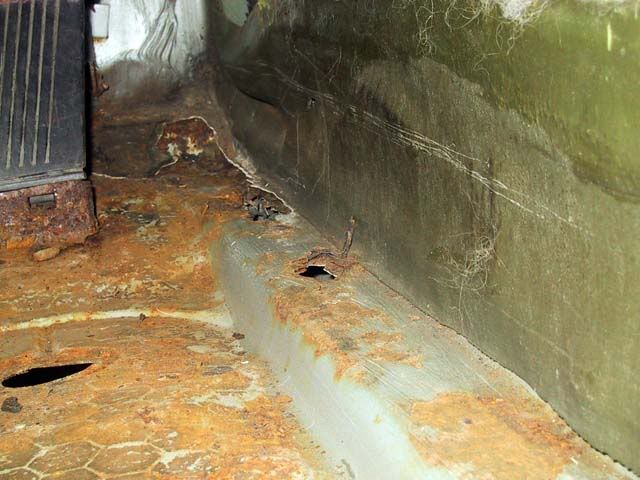

        I just ran 2GA cable, it already had some pretty thick shielding around it which would protect it rather well, but just to be safe i used some garden hose, cut it down the center to split it open then wrapped it over the wire. Very little chance of something rubbing through it now, just wanted to be sure it wasnt going to earth to anything :)
        When you look along the sill you will see it basically has sheets of bitumen installed to cover access to where you can run the wire. Just chip it off and replace it once you are done.
        Excuse the rust, but you can see the stuff covering it there :)
        Just a little project im working on
