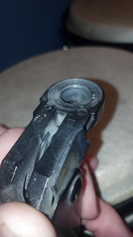

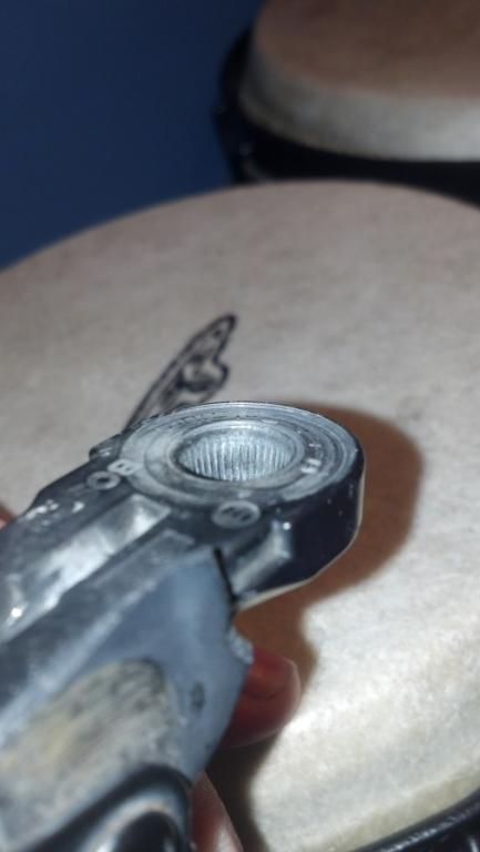

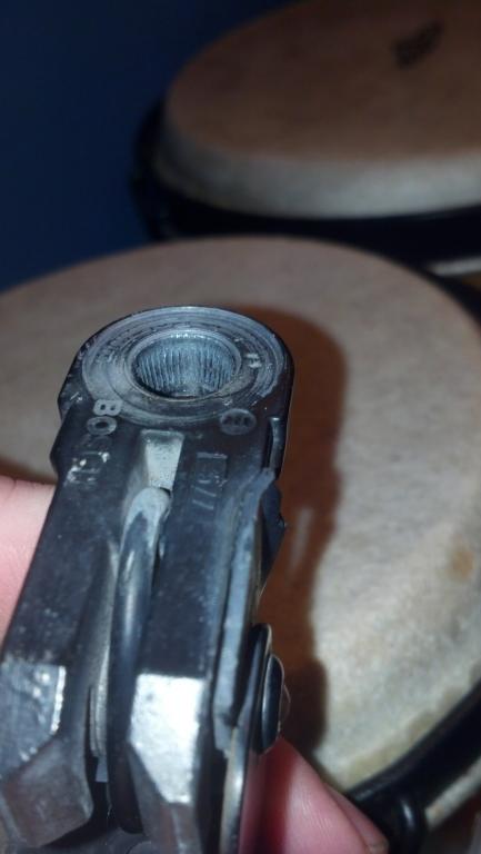

            Also, some shots of the wiper arm (it's 11 out right now, I'll try for spindle shots tomorrow).

                If it's the splines you can put a small piece of thin soft metal (copper, aluminum, etc) in the joint to tighten it up.
