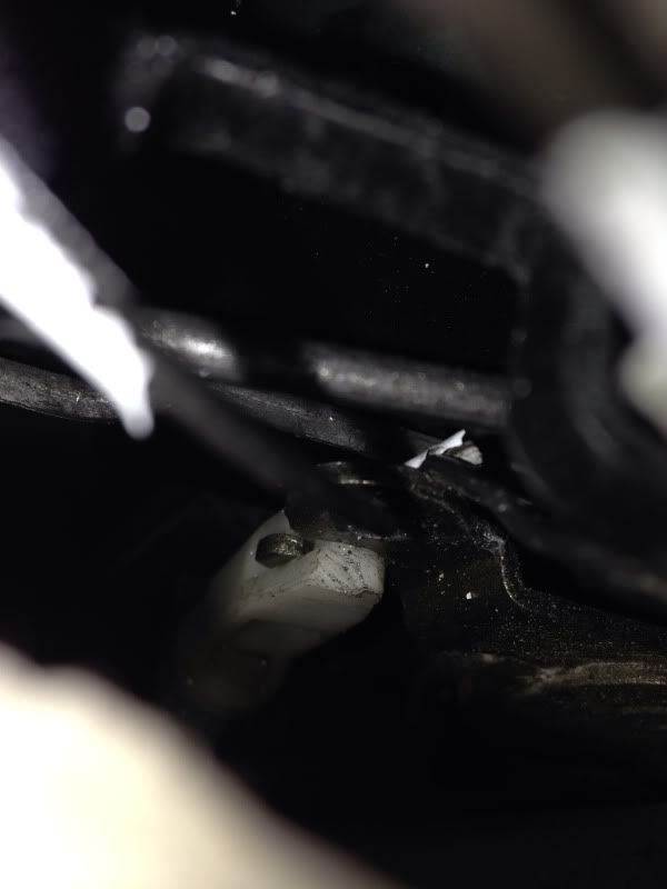

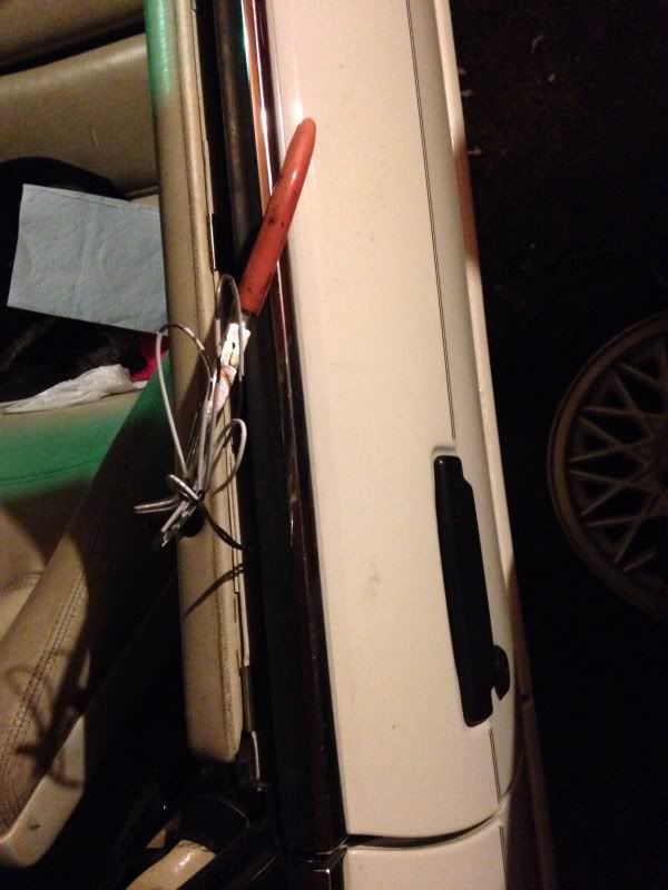

    So my passenger door was deadlocked shut. Only way I could easily access the actuator to break the deadlock was by removing the inner weather strip. Theres a hole you see in the second pic that you can hook to manually pull up on the actuator to break the deadlock. First I tried fashioning a hook from a clothes hanger. The actuator is pretty damn strong. The hook kept breaking loose. Then i figure a better way was to loop the clothes hanger in and out to give me more leverage. I figure it took about 50ish lbs to break that actuator loose. I'm keeping it manual for now!!!

      its only accessible with the window down. Otherwise if your double locked out it'll probably be impossible to get in
