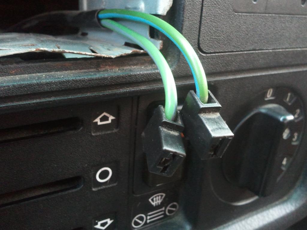

    Hi, according to the last post, i capture some photos to show you exactly the wiring connection.
    On the first attached photo, you can see 2 blue-green wires. These 2 wires are connected on the window breaker switch.

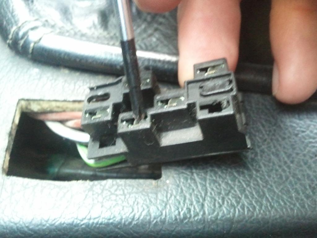

    The second photo shows the wiring behind the driver's window control switch. I checked the circuit between the left wire of the first photo and the #3 pin (to the point the screwdriver points) on the driver's side. I hear the "beeeep", so there is no wring cut.

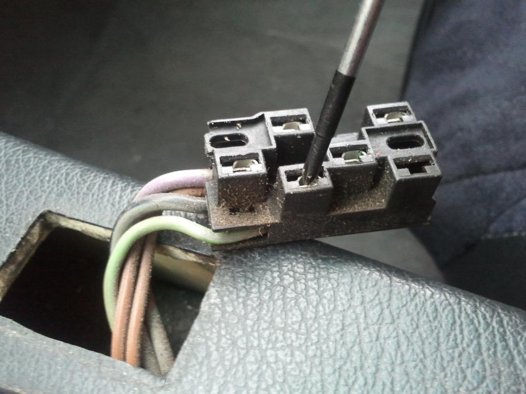

    The third photo shows the wiring behind the passenger's window control switch. I checked the circuit between the left wire of the first photo and the #3 pin (to the point the screwdriver points) on the passenger's side. I hear the "beeeep", so there is no wring cut.
    In addition, there is a circuit between the #3 pin at the driver's side and the #3 pin at the passenger's side.
    The spare blue-green wire (the right one) is used for sunroof (not used). My windows are free to be used, even though the window breaker switch is pressed or not.
    Any help? Any advice? The circuit seems to bypass the window breaker switch. I do not know why...
