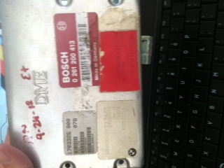

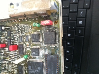

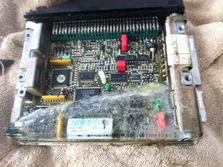

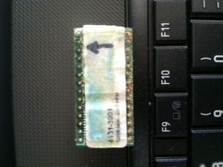

Well, it seems I may have narrowed down the issue here. I had no power at fuse #11. I can feel the fuel pump relay clicking away while cranking. I removed the pump and manually jumped it, pump works. I decided to take a peek at the DME to find an icicle hanging from it! I thawed it out, but something got my interest. The DME is a red label from and M50, not the S50 supposedly in the car.....I looked on the forum to find that I guess you can do that but you need a specific chip. Well, from the looks of my chip, I can't tell what it is. I have definitely been mislead from the beginning with this car, the kid hosed me. I thought what I was getting was a decent shape car that runs like a bat outta hell, but now I have this block of ice. I'm a little pissed and need some guidance and encouragement. I am pretty handy and can do most anything on these cars.
How much am I looking at for a DME and a chip, etc.... I also noticed under the dash this is an EWS car, the kid had the antenna ring with a key in it taped under the dash. I'm assuming if/when I replace the DME I need to align them? Also does anyone in the Warwick NY area have a DME for me to plug and play to ensure that is what I need to start!

Holy hell! Find the right DME that works with your swap. Remember there are different s50 motors. OBDI and OBDII.90 325i DD/Track

Right, which the kid said it's an s50 from a 95, so OBD1. But I now question if it is a true s50, how can I be sure. Why would he be using an M50 325i DME in the swap?Comment
Using M50 Red Label DME is completely correct and right way of doing it. There are several DMEs that work, red label is one of them. It does not matter if you have S50 or M50. Chip seems to be Turner Motorsports from what little I can telll on that photo.
Your problem is wet/frozen ECU. You need a new one and a chip. I'll look around to see if we have any of them left at the shop you can buy it along with door cards :)Comment
You have (had) Turner Chip 4131-3001 OBD I S50 with Euro HFM https://www.turnermotorsport.com/pag...ation_2008.pdfComment
