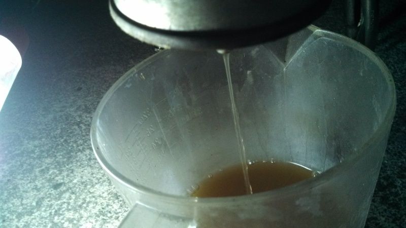

    Picked up lovely 318is two weeks ago... When I test drove it in January it ran fine, but driving it home there were some issues. When accelerating in second gear, it seems like the car was about to stall out until it hit 3k RPM, and after shifting it was fine. If the car was put in neutral(slowing down for red lights) it would stall out, but could be restarted just fine.
    I changed the spark plugs and fuel filter, but that didn't help anything. When I pulled the old filter, the fuel was brown and murky, as you can see in the picture below. Would a clogged fuel pump/fuel lines be causing this? I'll be getting another tank soon, but until then she's not going anywhere :(
    A rusty tank can cause fuel starvation from clogging of the filter or the inlet screen of the in-tank pump as well as wear in the high pressure pump. That picture says to me that the car needs to have the tank acid cleaned and sealed or be replaced. It will also need a new filter and pump(s).

        Thanks guys! I've already sourced a good used tank, and hopefully I'll be able to get it within the next week. Any recommendations on fuel pumps?
          OE/OEM pumps are best.
