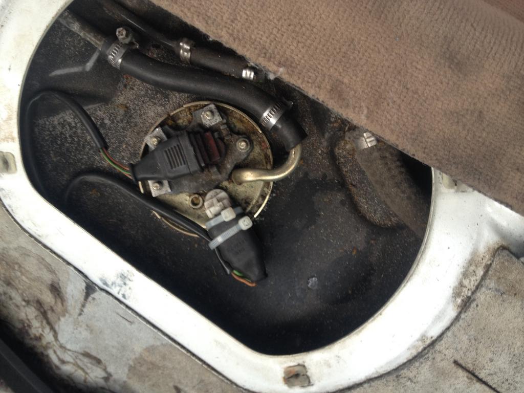

    Fuel Relay Sensor
    Hello R3v,
    I am trying to find a sensor to connects to the fuel relay I believe, in the picture it's the one with the zip tie on it. Thanks.
  • edoc
    • Jun 2013
    • 16
    The one with the zip tie on it is power.
      Do you know where I can find just that plug? Looked at pelican parts and rock auto but couldn't find it
      • edoc
        • Jun 2013
        • 16
        Just did a quick search and couldn't find anything. Are you not getting power to fuel pump? Best bet would be a junk yard. I don't see a problem with stripping the ends of the wires a little and hard wiring it. Do it properly though, essentially making your own. Something like this http://www.zeebuck.com/bimmers/tech/...fulepump01.JPG
          I'm getting power it's just a very loose connection, and if I hit a bump, it's disconnects itself.
          • edoc
            • Jun 2013
            • 16
            Alright just wanted to be sure because I just went through that issue. Anyways, I don't see anything online. Junkyard if you really want that plug on the end, but again, you could wire it yourself and have it be reliable in under 20 minutes.
              I may end up just doing that, thank you very much for the help.

                Does it have a part number on it?

                  Mine says BMW 1379579 on the rubber cover of the plug. After a quick search, other people seem to be looking for this plug with no luck finding it. In the forums where I found people looking for it, they're calling it a coolant level sensor. So BMW probably uses that plug for a few things.
