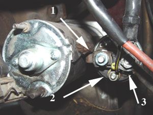

    I need help installing the starter of my 89 325i. The starter was removed during the engine rebuild. Know I can't remember where each cable goes. It has four cables. The bentley does not provide enough information about it all it says is the qty of cables but does not shows their location.

    Maybe this'll help.

      Let me see
      1 = ground cable
      2 = signal from switch
      3 = 12v from battery ( big red cable)
      is this right?
      by the way thanks for the picture!!

        3 also runs to the red cable coming off the alternator.
