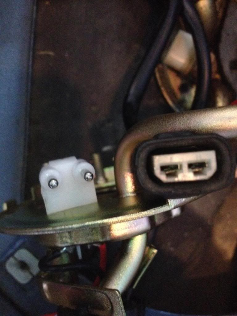

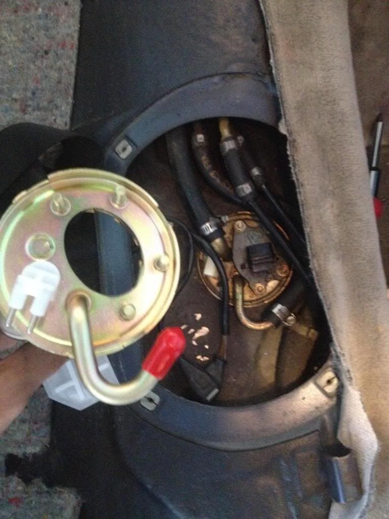

    You car came with two fuel pumps, a low pressure supply pump in the tank, and a high pressure pump in front of the driver rear wheel. What pump did you replace the in tank pump with? Did you convert it to a single high pressure pump? I can't imagine why the correct replacement pump wouldn't fit, unless a prior owner converted it in the past...
    Before you spend more money replacing parts, I highly recommend getting a volt meter and fuel pressure gauge, and spend a few hours going through all of the checks in the fuel management section of the Bentley manual. You will find most, if not all, of your problems right there. Also, you will see over and over again that an intake leak test (smoke test) is critical on these cars. Vacuum leaks can cause lots of problems, but if you don't have access to a smoke tester, it is (in my opinion) more cost effective to simply replace all of the gaskets and seals as preventative maintenance, than it is to pay someone to do a smoke test and tell you you need to replace all the gaskets and seals because they leak. You can source all of the parts for about $150, and replace them with standard tools in an afternoon (including a new intake boot and crankcase vent hose) to ensure you don't have any vacuum leaks, and won't for a long time.

          I was going to track down the problems a little more in-depth but when the car was acting like it does, I instantly assumed fuel pump. The pump I bought was a factory replacement from autozone but it did not match the one in the car.
          In the second photo, there is 2 hoses running out of the one inside the car; however the replacement only has 1 hose spot. The other is welded closed? I believe it is the return hose?
