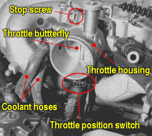

            • BMWZ4ANDE30
              • Nov 2005
              • 158
              which part are you referring on this picture?

              • HST
                • Jan 2006
                • 757
                none.
                Part #1 here
                http://www.realoem.com/bmw/showparts...97&hg=13&fg=15
