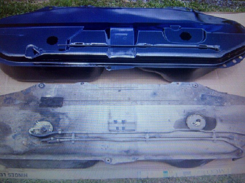

    Hi:
    I have searched everywhere and cannot come up with the part numbers for the two metal fuel lines that run over the top of a late model fuel tank.
    These lines are not listed on RealOEM on the diagram showing the metal fuel lines that run to the front of the car, nor do they appear on the diagram for the fuel tank itself.
    The car in question is an 89 IX, although all late model cars should be the same.
    On the picture, the metal lines are shown on the older tank.
    Help ...

    make some new out of copper?
    they also wont rot away in the future.
    personally i just made some out of plastic tubing because my car was puking loads of fuel.

      Give Levent at guten parts a call, I'm sure he can help

        Considering they are basically straight lines, just buy some fuel line from your local parts store and make them yourself. Should be able to get stainless so they won't rust.

          Thanks, guys. I'll pick up a length of metal line from NAPA and go from there.
