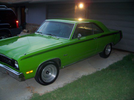

        Here's a pic of the Scamp, I beat myself up everyday for selling this car for what I did, it had the 340 RT engine for anyone who knows what that is.
        sigpic87 325E The Honey Badger

          Very cool, you don't see Scamps very often! :up:
