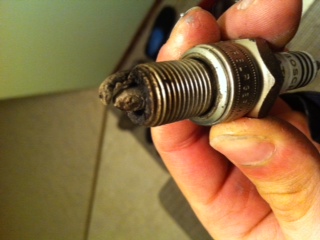

Car started flooding itself when trying to start up, and would occasionally choke out and stall when idling. +was still dumping major fuel. Decided to pull a spark plug and sure enough the plugs were fowled in a major way.
What did it I think was they were needing to be changed, and then we had a cold snap which caused the car to run extra rich and push them over the line. New set of NGK's and it's running smooth as silk again.
How it brought the econometer back to life, I'm not so sure but I'm happy to have it fixed
