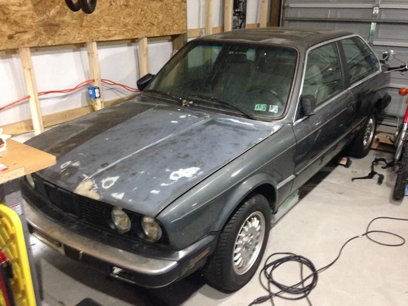

    Hey everyone, so to start, I'm Ty and I'm new to the e30 world, but not new to car forums.
    With that being said, I went to check out a 1987 325ES (project-ish) car the other day and decided I am going to buy it and I have been making a list of things that I am going to have to replace. I was wondering if anyone had a similiar list that they could expand on mine, and/or help me find parts to mine.
    The first part of my list is just engine/mechanicals, the engine will be pulled so I don't have a problem replacing some things. So far I know I need to replace
    • Waterpump / Timing Belt
    • Brakelines
    • Hoses
    • Flush the ICV
    • Trans seal leak
    Am I missing anything else that I should change out and/or fluids I should flush?
    The next thing I need is an exhaust since the one on it is beat up and will not pass inspection, I have been looking online and found an oem one for 300.00, but would prefer to get an aftermarket one with a little more rumble to it, does anyone have suggestions?
    Thanks for the help everyone!

      Welcome. Everything on your list seems good. I'm with ST1G though on the ICV just let t be if the car isn't rough on idle. Change the air filter and you'll be good. Also with ST1G on the exhaust 300 would be getting robbed imo. Just find a nice Remus/magma flow etc. And you'll be good. Btw pics of said car???
      Edit- car will most likely need the oil pan gasket replaced. Seems like they all do unless it's been done already.

        The sale is pending so the car is not currently in my possession, but will be in the next week or so
