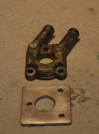

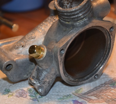

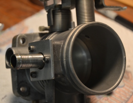

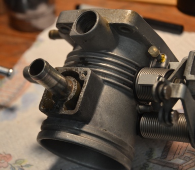

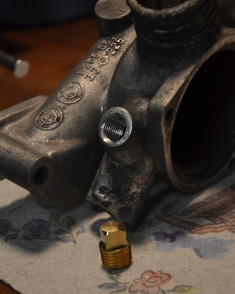

    Not sure if this is too popular, but while replacing all of the coolant hoses on my newly acquired Cabriolet, I decided to delete the two small coolant lines to the throttle body - did the same mod on my E36 years ago.
    There were three areas that modified to delete these lines. First, I drilled out the thermostat housing and taped for 1/4-18 NTP brass plug. Next, I also made a plate for the throttle body to cover the removed coolant line manifold. The last step was to plug the hole with cylinder head with a metric plug available through BMW. It was a few hours of work and removes two coolant lines that run under the intake manifold. I am a big fan of removing unnecessary stuff...
    I have included a few pictures.
