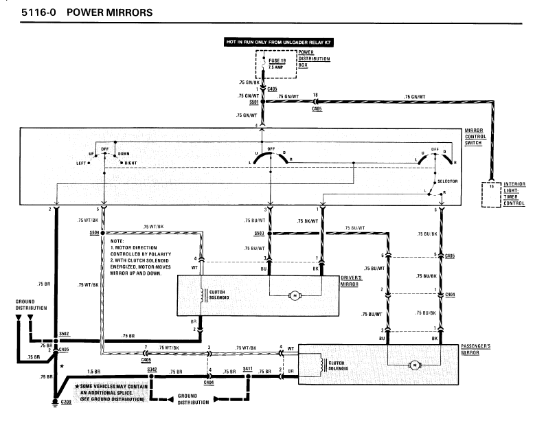

    Hi: Been working on the power mirrors on my 85 323i. Do not have power to switch with key in run position. Fuse has been replaced....all fuses are changed. Did notice that #23 was burned out, replaced it but no mirrors. The glass moves around ok....any relays or ideas I should check out?
    thanks for any help,
    jm

      Hopefully someone will jump in here with some direction on this one. I suppose I could trace the wires, might have too....just feels like something is not connected.???

        check and clean the harness door jamb connector ,and while your doing it check correct pin for power (pin 1 of connector C405 GRN/BLK wire?)
        download your ETM or one close and it will show wire color and pin number and connector diagrams
        http://www.wedophones.com/BMWManualsLead.htm section 5116
