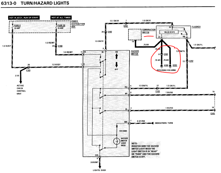

    Change the hazard button to start and see if that's the issue. I had a blinker problem and that solved it.
    Check fuse 4. although I doubt that's the issue.
    Check connector C103.Violet/grey wire. Connector location is shown below.
    full PDF here.

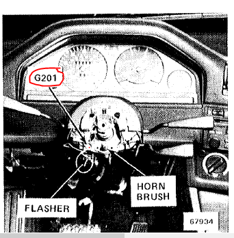

      do the outside lights work with stalk moved to either direction? or is it just the bulbs in cluster dont flash?
      if not normal cause for loss of turn signal operation from the control stalk is the ground wire coming loose in the column , remove the steering wheel and column cover and find the brown ground wire coming off the stalk and find the other end which should have an eyelet with a screw holding it to the column assembly ,make sure the screw is tight ....

        picture for reference
        seen here
