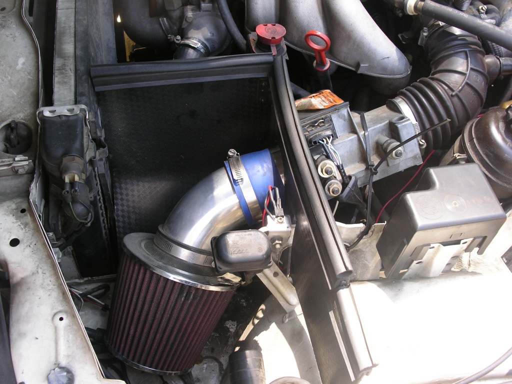

            Thanks Robert, that worked perfectly. I've got the apexi reading rpm's and throttle angle correctly now. Here is how I mounted up the regulator

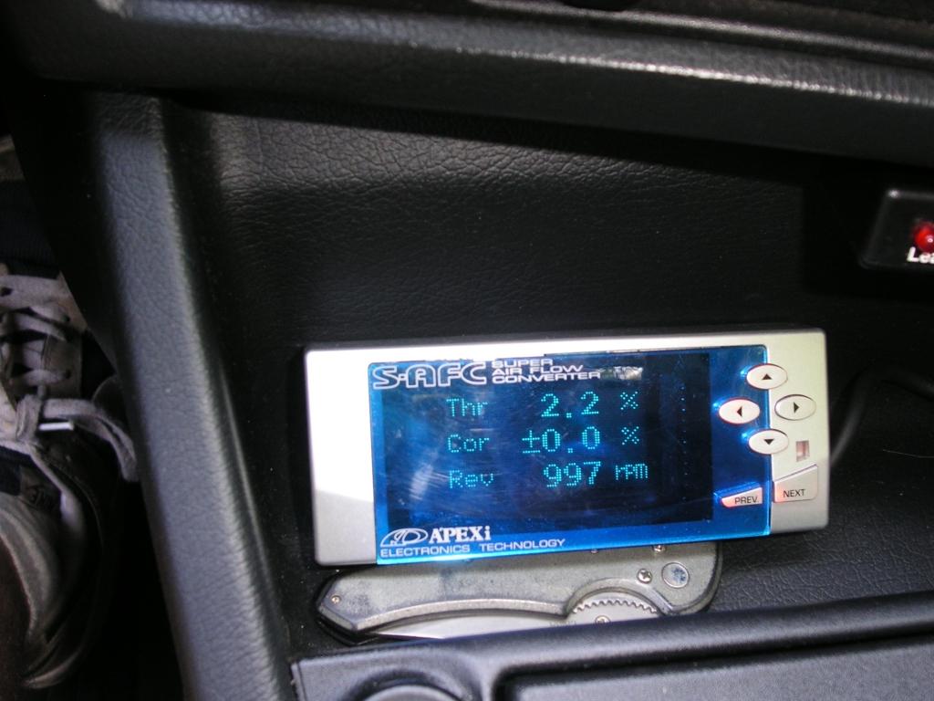

            Shot of the apexi sitting in the consule
            Getting some readings
            Now I just have to find a sensor type in the apexi that works with the factory afm, I've tried a few and with them all it's throwing a different sig, back to the ecu and the car goes full lean at 4500. I already now the sensor # for the MAF, but would like to play around with the stock AFM first a little.

                The apexi dosn't actualy have any real mapping ability. It has a bunch of preprogramed inputs and outputs, so you select the one for your car. Then from there is gives you the ability to adjust the output either + or - at any 8 500rpm increments you set. So right now I have it set at
                1000
                1500
                2000
                3000
                4000
                4500
                5000
                5500
                It then has 2 maps you can create, one for low throttle and one for high throttle. So you set the low throttle one for idle and moderate accel, then the high throttle a little richer for high throttle acceleration.
                To set you have to an air/fuel ratio guage and a wideband o2, then at each rpm increment start adjusting the curve either + or - till you get the air/fuel ratio you want at that rpm point.
