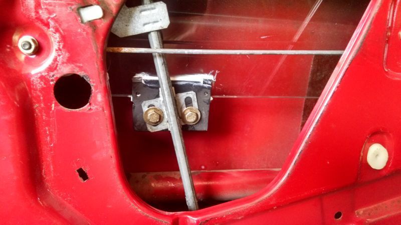

            I had what sounds like the exact same issue on my '87 e30 that has the push-pull cable mechanism thing (note at some point in '88 the window mechanism was changed to a scissor, I don't know of this would apply to it as well). Anyway, there are two aluminum brackets that hold the bottom of the window. My rear bracket was broken and was quasi-holding with the PO's solution- gorilla tape, which kept making the window jam on the b-pillar on the way up. The bracket doesn't come separately, so I just made one out of some scrap steel - free, and works perfectly. To make one out of steel, all you need to do is make the number four shape (open four, not crossed) and have the holes lined up right. I welded mine, but probably could have used some screws. Make sure to paint it so that it doesn't rust inside the door. I think I have some pictures of it, I'll check tomorrow and can post them here if I do.

                    I would guess its (a). I would think that when it was loose it got out of position. Here is a picture of how my homemade steel bracket (black) sits with respect to the thing that is attached to the vertical rail. The position of those two bolts is adjustable in the slots. The way I adjusted it when putting it in was getting the window roughly level by eye and tightening the bolts, putting the window almost the way up (like a half an inch away from the top), loosening the bolts, then moving the window with my hand until the half inch gap was even all the way around the top edge, then tightening the bolts.

                      I think you're right. Thanks a lot for the pic. One of my stupid mistakes was not rolling the window down to retighten the bracket so this should make my life a lot easier haha. Thanks again for all your help. I will give it another go around. Hopefully you don't have to hear from me again.
