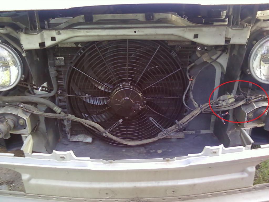

    Can someone take a picture of where the condenser fan plugs in? Over by the evap canister I have one that looks like it would fit but the ground cable from the compressor is plugged into it and I have no other matching harnesses. Thanks!

    If you're talking about the power connection its between the driver's side headlight and the fan.

      Somewhere in or near the red oval

        Ah thanks I will check it out this weekend. When I put my AC back together I may have mounted the fan wrong because the power is going to the passenger side. No fan means warm AC when not moving and I live in AZ !

            Thanks that's where the plug was. AC blowing cold now :)
