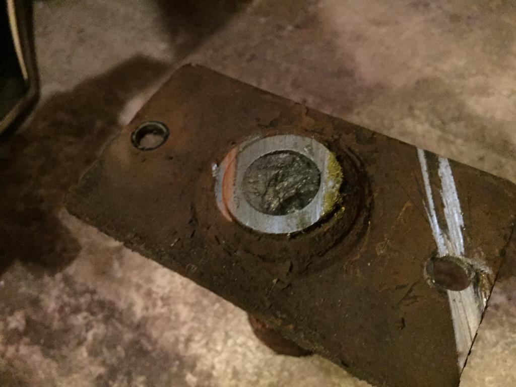

                              Got them off, but not how I wanted. Just had to cut the mount in half. Anybody have any mounts for sale?? Lol. Either that or I'll weld them back together.
                              What were they filled will with from the factory. Were I cut there was a little bit of stuff, but it was like a gel. (Like the inside of a stretch Armstrong). Not sure what kinda of movement the shocks would have normally, but that action was also seized.
