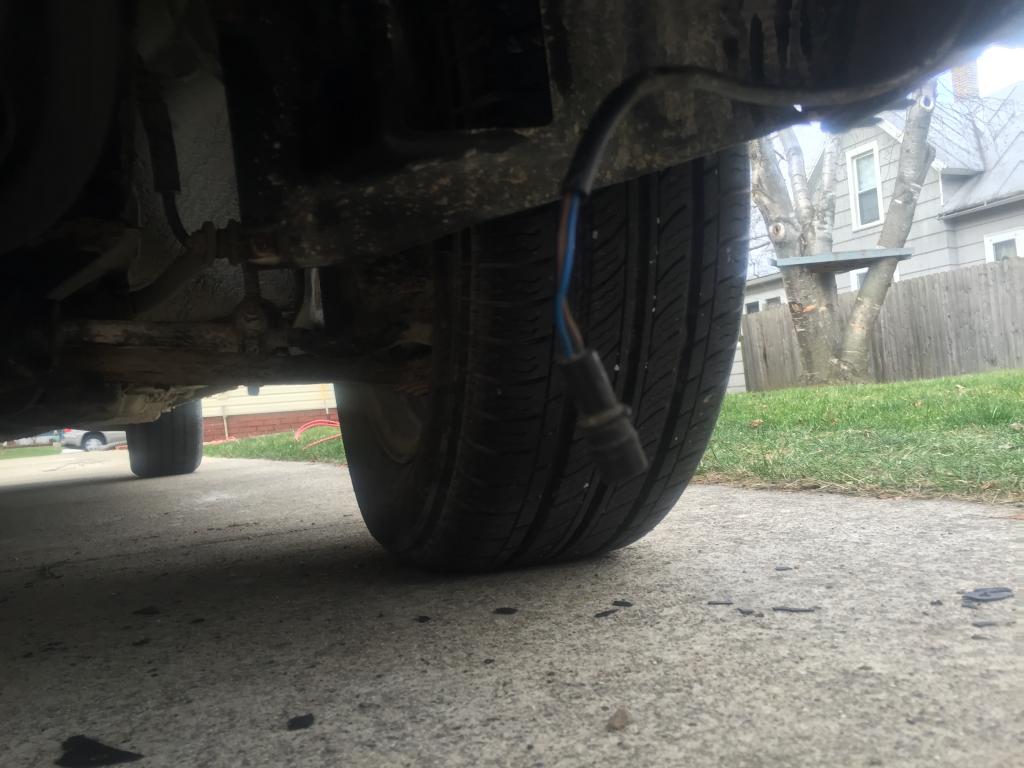

Does anyone know where this connector attaches??
    This mystery connector is hanging under the front bumper on (US) drivers side. It is round with a blue and brown wire. It runs up and over fender in engine bay, im not seeing its source?

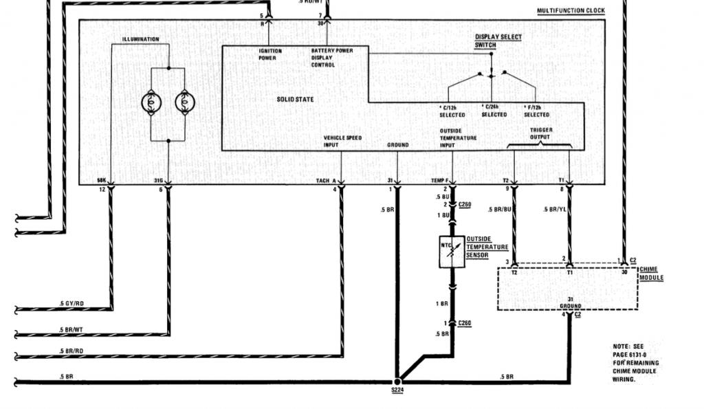

    It should be your ambient temp sensor I think. Do you have an iS? brake ducts in place? look inside it to see if there is a TC hanging out in there.
    Edit: See attached schematic.
      It is 88 e30 325e, ill peek around more and see if i can find anything.
