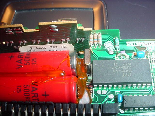

    However my batts have been glued in as seen here

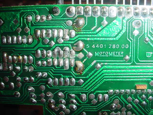

    and it looks like there may have been a bit of acid leaking as seen from the underside of the board here
    So basically, what do I need to do to get my cluster back owrking again, with or without the si board. and in the most cost effective way.

    I don't think that's acid - looks more like flux. I had the same looking batteries in my VDO cluster.
    The glue isn't what's holding the batteries in - its the solder points. You'll have to remove the solder and the batteries will pop out. In my case - the glue was more silicon like - probably meant to support the batteries.
    I wound up removing the batteries entirely and buying 2 AA battery holders from radio shack and 2 ni cads. I wired up each battery holder individually to the board. The negative side is the one with two prongs going to it. I jumpered the two together.
      anyone know what type of battery to buy, can I get them at radioshack? maybe even a part number? Thanks
        I just used generic AA Ni Cads.
          Radio Shack pn 23-191. $9 for two. They are being slowly taken from the system, get them while you can. Go to radio shack and order a couple pairs, they can have them shipped to your local store. Ask me how I know.
