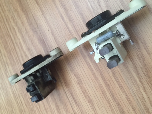

    Voltage regulator's, difference between new and old.
