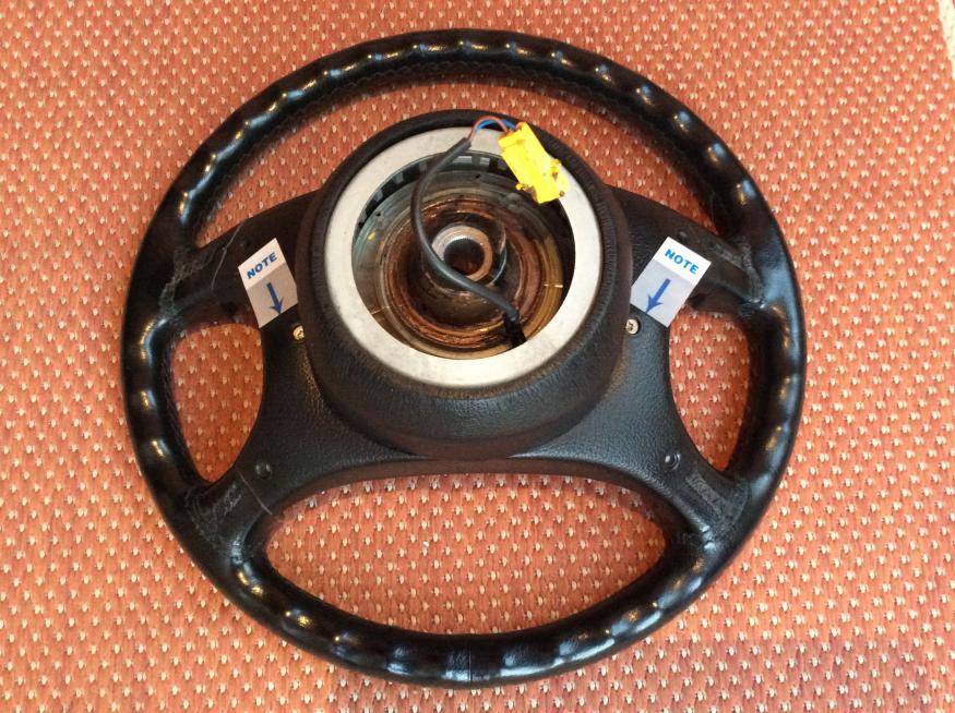

1) disconnect battery ... wait 15 minutes so that the airbag capacitor in the circuit deactivates & won't explode by accident
2) with steering wheel unlocked, turn wheel 1/4 turn left or right to give access to the 2 torx crews on the back of the steering wheel
3) locate the 2 torx screws on the back of the steering wheel @ three & nine o'clock ... loosen them enough until airbag releases ... see pic# 1
4) after pulling the airbag away, unplug the orange airbag connector & set aside the airbag for reuse/disposal ... reconnect the battery

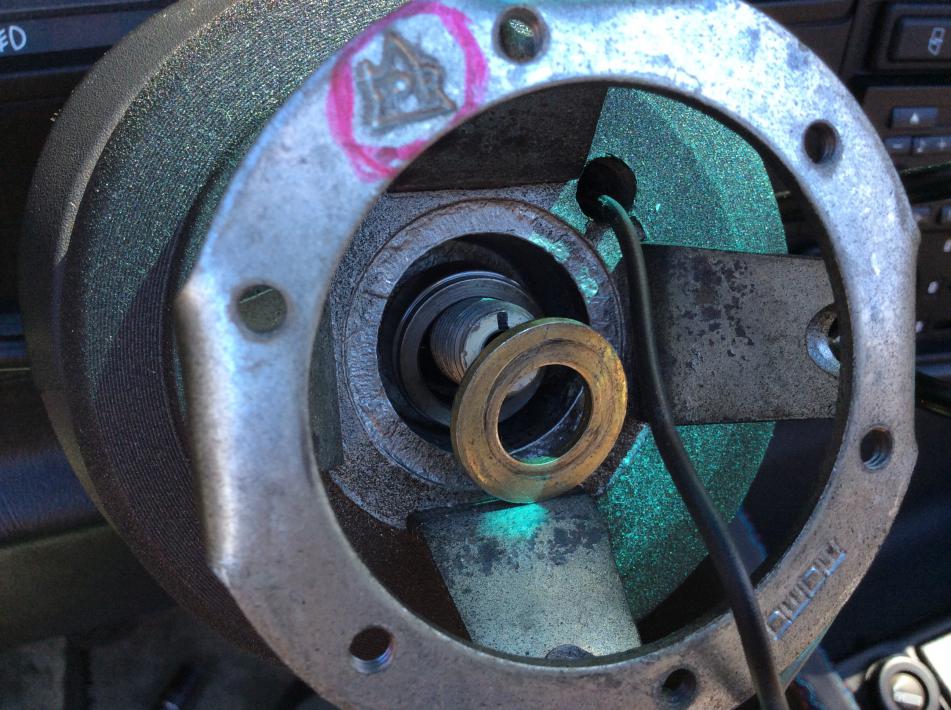

7) remove the spindle's 22mm nut ... the 2" extension on the ratchet allows the wrench to rest on the steering wheel rim at a perfect 45 degree to help loosen the bolt with even pressure as you untighten it
8) after removing the 22mm nut ... observe & remember the location of the washer under the big nut ... then remove the washer & safely set aside for later when you reinstall ... see pic# 2

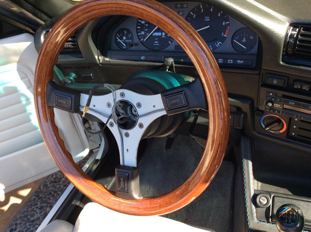

14) remove the rubber ribbed sleeve on the outside of the hub to aid access & set aside ... turn ignition to accessory position ... now position & slide the momo hub onto the column straight ... now turn off ignition to relock the steering wheel ... notice that there is a little triangle with the word "top" on the silver ring of the momo hub to help make sure that you keep the wheel's orientation straight ... i circled the triangle with a red marker in the pic for demonstration purposes ... after the hub is on & positioned straight ahead, first place the spacer (part number 32 31 1 120 260) onto the center spindle ... secondly, stack the washer that you took off earlier back onto the spindle on top of the spacer ... lastly, screw your original 22mm nut back onto the spindle ... see pic# 3
15) finally, cinch down the 22mm nut tightly

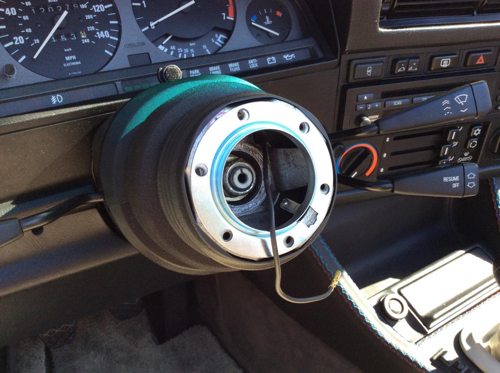

16) slip the black rubber ribbed sleeve back onto the momo hub ... now position the aluminum ring with the six holes on top of the hub ... notice that the aluminum ring has a contact point for one of the horn wires ... make sure that this contact point is pointed downwards ... the black wire w/connector that you see hanging there in the pic is the other horn wire
17) grab your steering wheel ... it should have two wires coming out of it to help complete the horn's circuit ... attach one of the wheel's horn wires to the hanging black wire from the hub via the connector ... attach the other horn wire from the new wheel to the contact point on the aluminum ring ... the horn circuit is now complete ... finally ... attach the steering wheel on top of the aluminum ring & cinch the wheel down with the 6 screws from the hub kit using the allen wrench which is included ... carefully position & tuck both of the horn wires into the hub's cavity ... see pic# 4

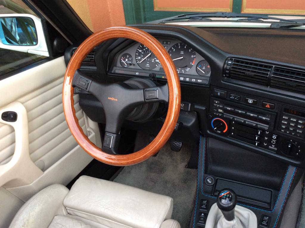

* last step is to attach the steering wheel pad onto the center of the wheel & you're good to go ... see pic# 5
