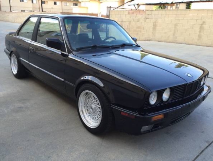

                        Well that looks pretty darn clean from this far away.
                        We lucked out - ours was only $1000 and didn't run, but it was a dry CA car, and had dealer service stamps in the book all the way up through 140k miles - we're at 175 now. But we've done a lot of work to it, and replaced some systems.
                          Thanks! she needs paint though in the future after i get her running better. There's some small buffing spots and touch up in some areas around the car. Im lucky that the car has remained in CA as well, the plates are original from 1990. Matching vins all around too which is nice
