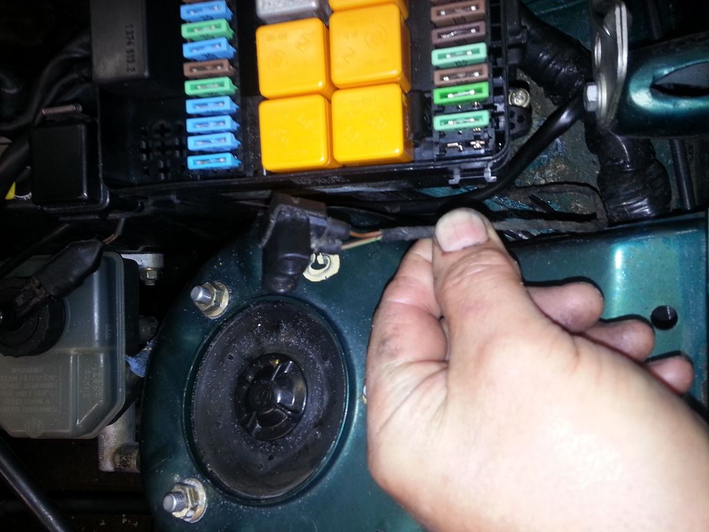

    I was pressure washing the engine bay and this connector emerged from under the fuse box...
    It has a brown and a brown-green wire, and it goes into the same sub-harness that connects to the outside air temperature sender. It's not the brake fluid level sender connector, because that one is still connected.
    1992 325iC
    That connector goes to the horn for the 13 button OBC code alarm. There should be a round horn near the strut tower on early model cars.
      Rob Dog...was that horn installed on late model cars? Mine is a 1992 vert.
        On late model cars the obc alarm horn is mounted in front of the drivers side front wheel, in the foglight/ brake duct area. It mounts to the bottom side of the metal that the abs pump bolts to. I just looked at my 91 vert and the obc horn is there and hooked up, but I also have the same plug near the fuse box as you and it is attached to nothing, weird.
          Thanks, Robdog. I tucked the connector back under the fusebox. Maybe they relocated the alarm horn so it was harder to disable.
