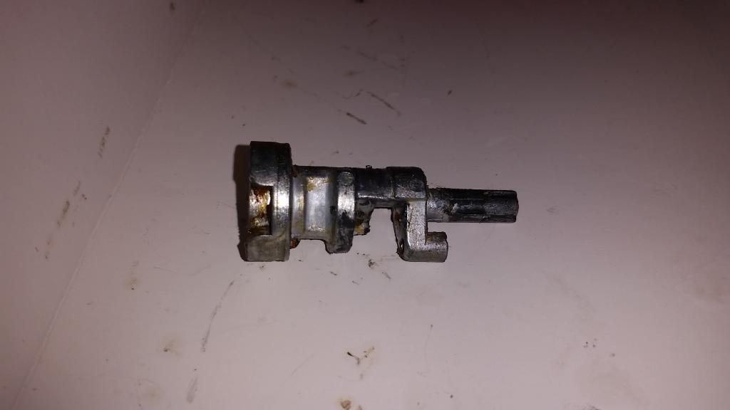

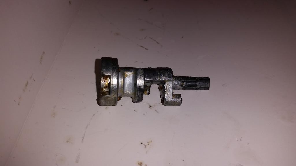

      Turns out there was a piece between the tumbler and the switch (with a spring and plastic tab) that nobody has every mentioned, posted pictures of, or is even on the parts blowup in REALOEM.COM..... that was the culprit! I had to purchase an new steering lock housing to get that part (32321156446 ). The one I got from FCPeuro actually came with a new switch and horn activator already pre-installed. The pic attached was the culprit. A small aluminum bit and tiny spring (not the bigger one) were loose in there. I have NO idea where they belonged...
